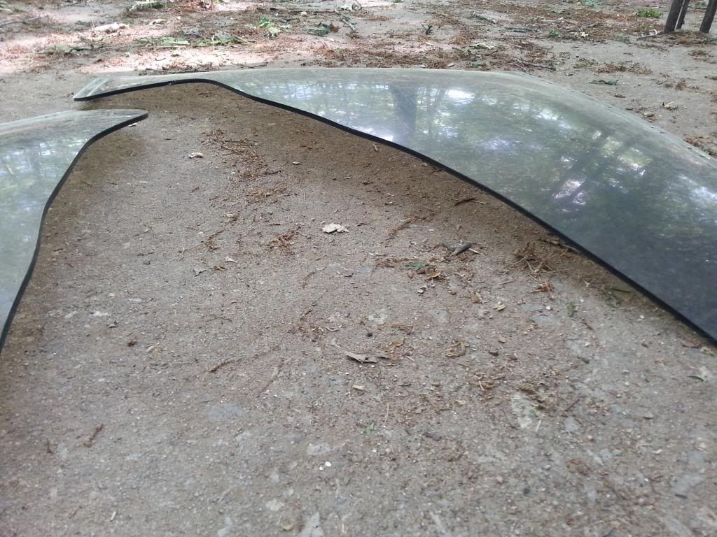

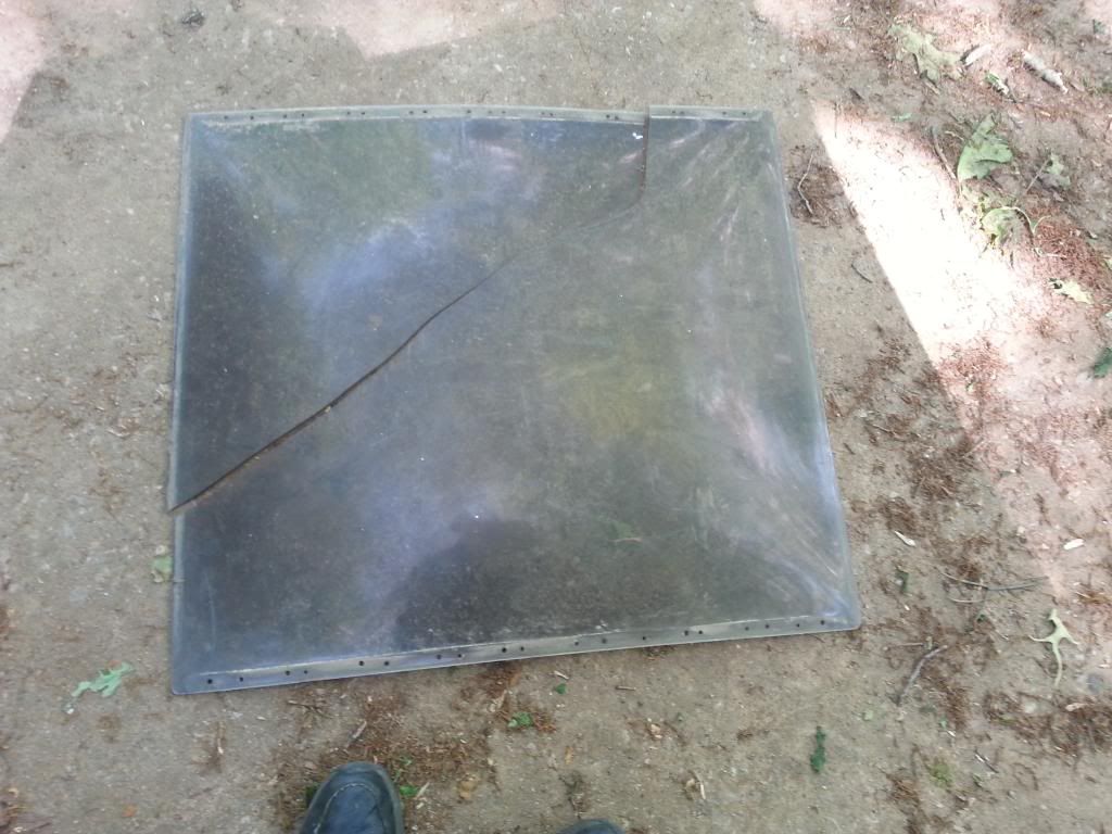

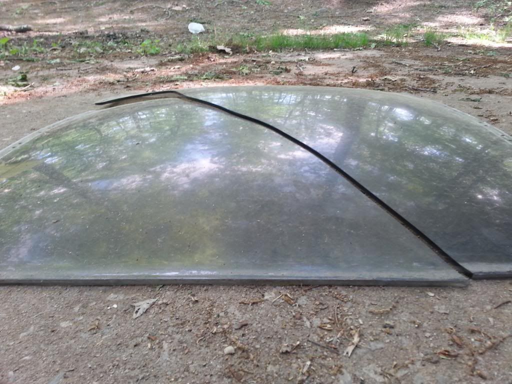

Girlfriends Daughter knocked over my companion way sliding top and it shattered.
Where can I get a replacement?

I have worried about this guaranteed failure on my H22 every since I got it. I presently have a 2 inch crack that will eventually look just like yours.
I have seriously considered looking at replacement 'windows' for skylights.. I think there might be a fit there, and would not be surprised at all if that was not the original source.
A higher end building supply place, or the internet, might supply an answer. The arch in the companionway is going to severely limit how well a flat piece works. If you use a flat piece, I think you're going to end up building a frame that has the arch built into it and is 1.5 or so inches 'tall' to get over the entire arched portion of the hatch.

EDIT: I see that flat stock will not work.. Only way I know would be to get a plastic shop to do it. They'll have to use the old slider to make a mold then heat- bend the acrylic to shape. Probably why you are getting such big quotes. An alternate would be to build a curved frame of wood or composite that would be curved on the bottom but accommodate a flat piece of plexi.
RE_Edit: OK I see a former poster suggested the frame.. The old slider can be glued together then supported in sand in a box.. then waxed and plaster-of-Paris poured into it to replicate the inside contour. That piece of plaster, once carefully removed from the original, will make a male mold .. A plastic shop would put a sheet of flat on top and controllably heat the whole thing and the flat sheet will drape onto the mold. Then the new part has to be finished .. labor intensive. .
