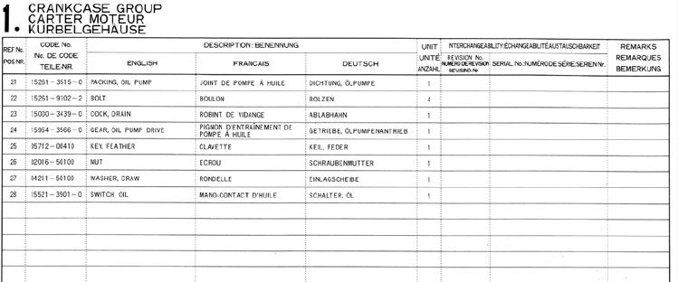

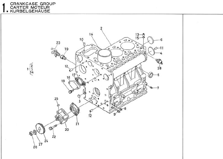

The attached are clips from the Kubota engine manual. My Kubota dealer could get any part with a Kubota part number but they could not look up any "Universal" numbers. The manuals are on the Catalina30 website. I had a C30 and kept the data

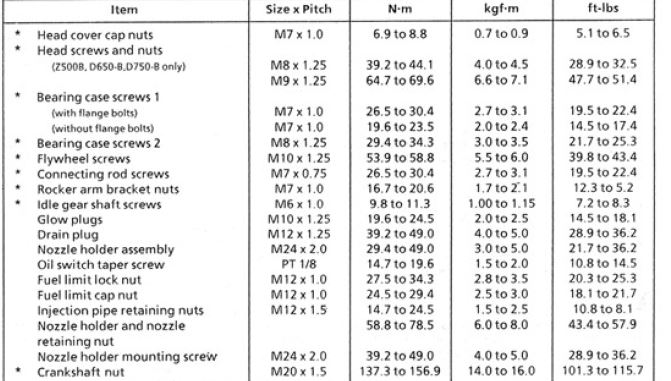

I believe you will find that he threads are metric tapered pipe threads that, to the inexperienced, look like english tapered pipe threads.

westerbeke p/n 299964
Kubota p/n 15841-39010
Or there's many available aftermarket -
You just need a 1/8-28 ("JIS" or "British" tapered thread, not NPT) normally closed switch that opens about 8 psi.
