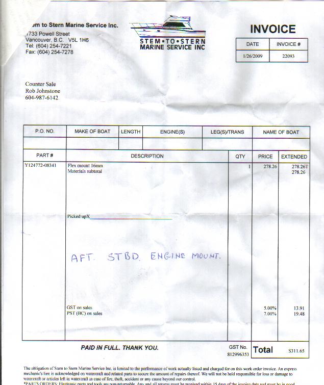

Has anyone replaced their engine mounts with mounts other than the Yanmar mounts?
They couldn't possibly be more expensive. This is for a 2GM20F and I'm sure your three cylinder would be even worse. However, as Woody says, don't go with substitutes.
Ever since I had to replace this little bugger in 2009 because of a small fuel leak, I've treated all of them like the holy shroud. All of them are still good after 15 years (except 6 for the replacement) and showing a clearance of about 3/8". My tell-tale for deterioration is in the alignment check every other year. Engine is just not dropping .................... or maybe the stern tube is dropping at the same rate :eek:.
Once you replace them, keep them sterile and they should last for a good number of years.
