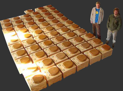

The typical marine head is a wet system. All over the world, dry toilets are becoming more common place.
A famous man, a long time ago said:
"All truth passes through three stages. First, it is ridiculed. Second, it is violently opposed. Third, it is accepted as being self-evident."
Arthur Schopenhauer
German philosopher (1788 - 1860)
I have a wet system in my toter home. Rather nice one. I also have a dry system in the toter and another in the toy hauler apartment / garage. I always use the dry systems. The whole camper smells better when the black water tank has no black water in it, and no clean up, no pumping out, no repairs.
