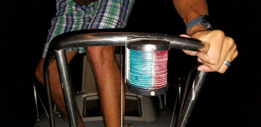

Is there any way to just replace the acrylic/plastic lenses on the Aqua Signal* Navigation lenses in the Nav lights on a New Model Catalina 22? Every one of my lights is intact except they are weathered so much that they are no longer transparent in any way. The black housing material is in 10 out of 10 shape, but the acrylic lenses is 4/10.
My anchor light actually cracked completely in two when I tried to remove the cap to check the light bulb!
I see some replacement units online but it includes the housing, the lense, the wiring, etc. Just looking for the clear, red, green portions.

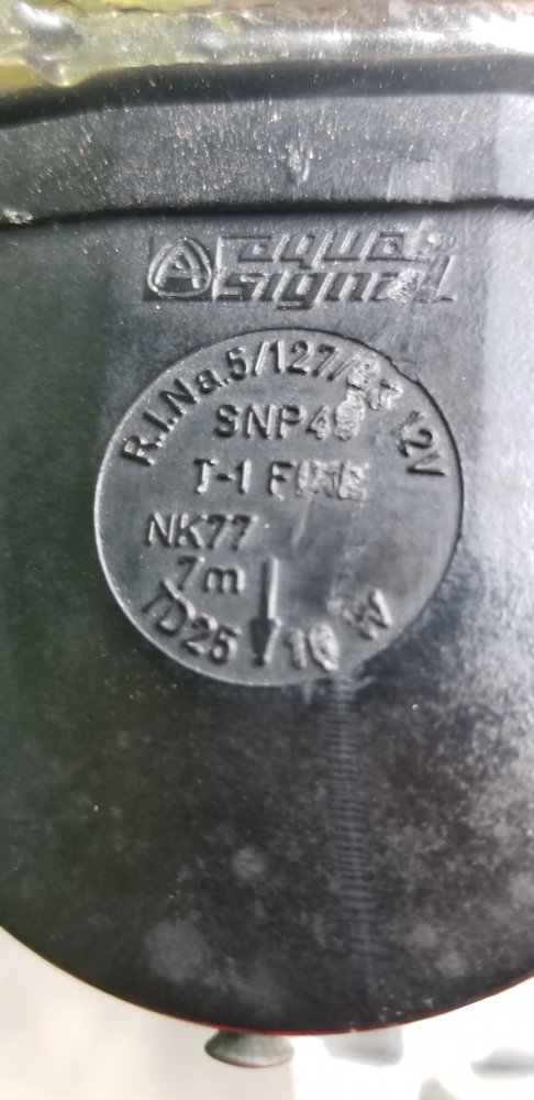

Pretty sure what you have is a Series 25 Aqua Signal (see the "TD 25" in the picture) .. Parts used to be available, but not so anymore I was looking for the bi-color lens for my Series 25 a couple of days ago and could not locate anything.. I found a clear lens for the stern light, and the individual red or green for a side light, but not the bi-color.. Anchor light lens: https://www.ebay.com/p/Aqua-Signal-...tion-Light/3017366456?iid=323374579239&chn=ps
The entire bi-color assembly is $25-30.. and I guess with the LED lights taking over, they've stopped marketing the lens alone..

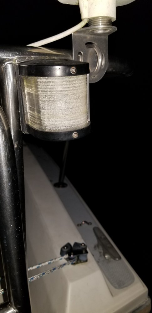

As shown in pics above, both stern and nav lights have the screw that goes in directly in the center top and bottom. The steaming light appears to be exactly the same as the stern, even though the black housing is different.
