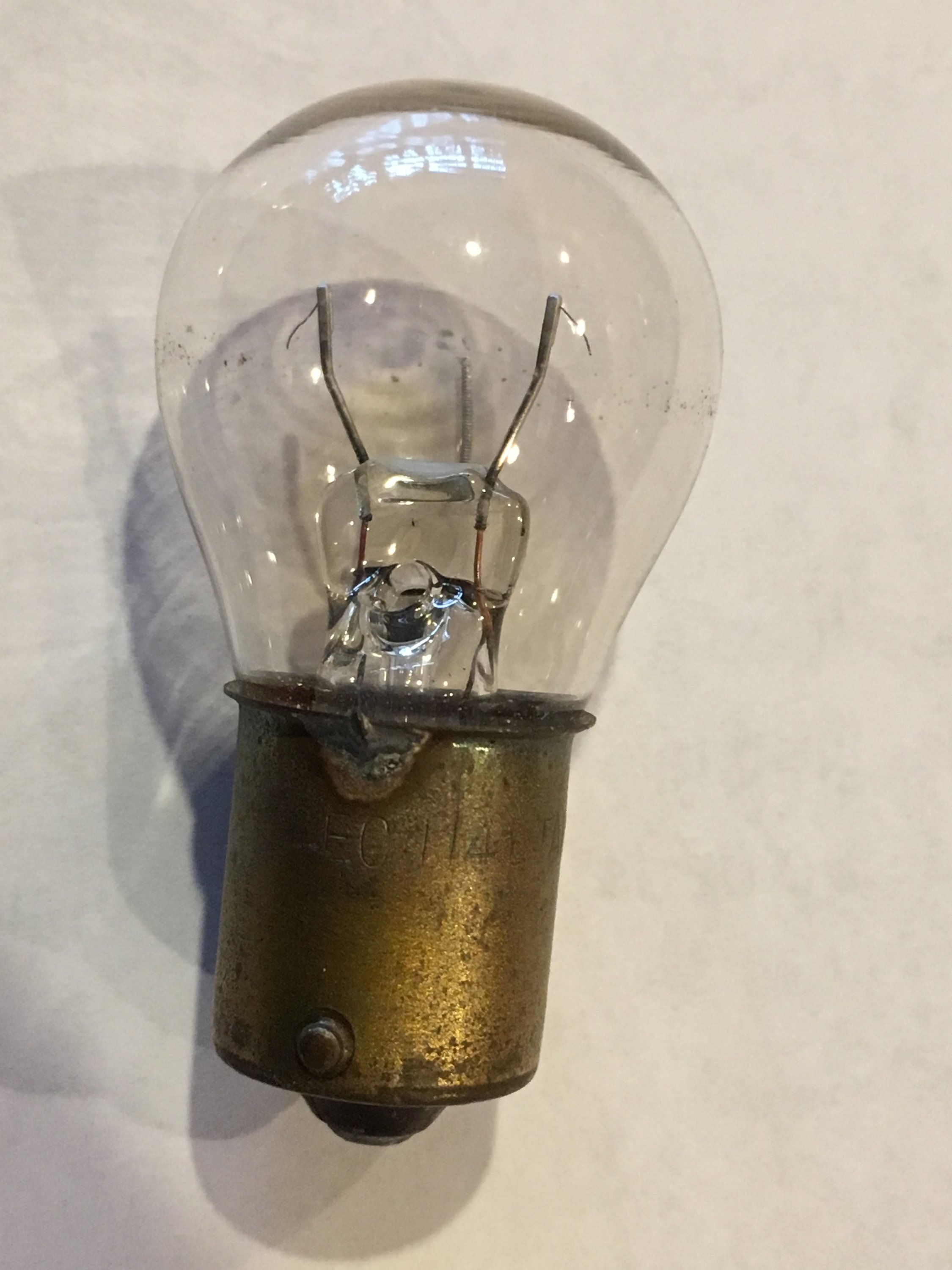

I contacted the folks at superbrightleds.com to get recommendations for LED replacement bulbs for my 1993 Catalina 30. For the old square lights in the head and quarterberth I was recommended 1156 -x27-T (their part number) which is a 420 lumen bulb.

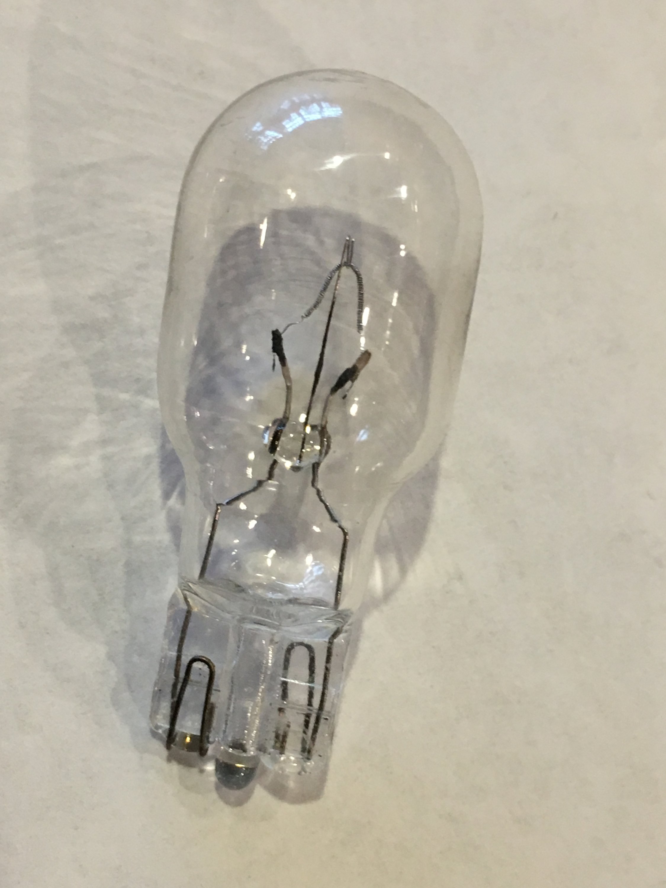

For the little wedge bulb found in the lights above the settees I was recommended WLED-xHP5-LAN which is a 90 lumen bulb.
When I queried the guy about the difference he then recommended a 260 lumen bulb. I said I couldn't quite rationalize the difference he said it was my choice.
So, does anyone have any idea what are the light output requirement for the lights on a 1993 C30.

Bulb2 looks just like the ones in my landscape lighting. I believe they have a T5 base. I got them on Amazon. They have different brightness choices.

Most of the old incandescent bulbs like those put out around 100 lumens not less than 90 and not more than 125 ish.. If you were happy with the old bulbs, some bulbs around 100 or a smidge more will have similar output as the old ones. When ya start looking, make sure the bulb matches the fixture, the "front firing" bulbs project light directly away from the base.. Something like a reading lamp fixture might use the front firing bulbs.. If the old bulb is kinda laying in the fixture and the sides are projecting light into the cabin, some of the round, side projecting LED's would work.. In both cases, you'll want a "warm white" color. Your "bulb 1" picture shows a BA-15S or a 1156 base bulb. If the fixture has space for the bulb replacement, some of these would work.. https://www.superbrightleds.com/cat/bayonet-bulbs/filter/Base_Type,1156,1,40:
The bulb in "bulb 2" picture is either a "T3" or a "T5", but without a size scale, I can't tell which..
Doesn't sound like the guy you are talking to at Superbright knows his stuff.. I'd study your fixtures carefully and then decide what LED you need for which fixture.. Good Luck.. I converted all interior lamps to LED about 6 years ago and have been very happy with the results..

Bulb 2 is a T5.
