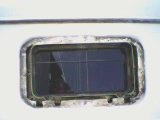

Bob mentions the NFM portlights. Just be sure you understand the work involved after you spend the $$$$. The attached photo illustrates the problem. There is a lot of epoxy work to get a good fit BEFORE you try to seal them. This is a bronze 7x14. NFM now makes a 7x15 which is a much better fit for the large Gray port holes. They also make it in stainless which looks super and does not turn green without constant attention.
