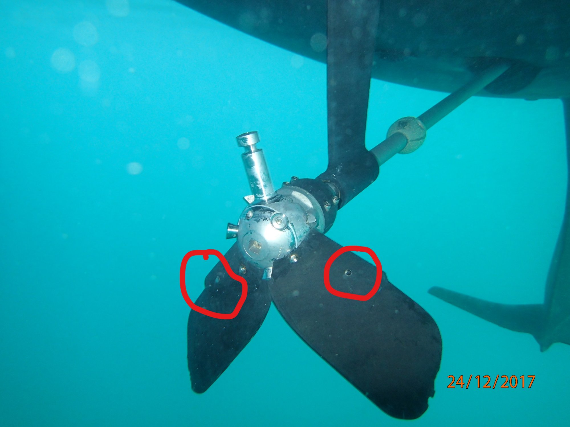

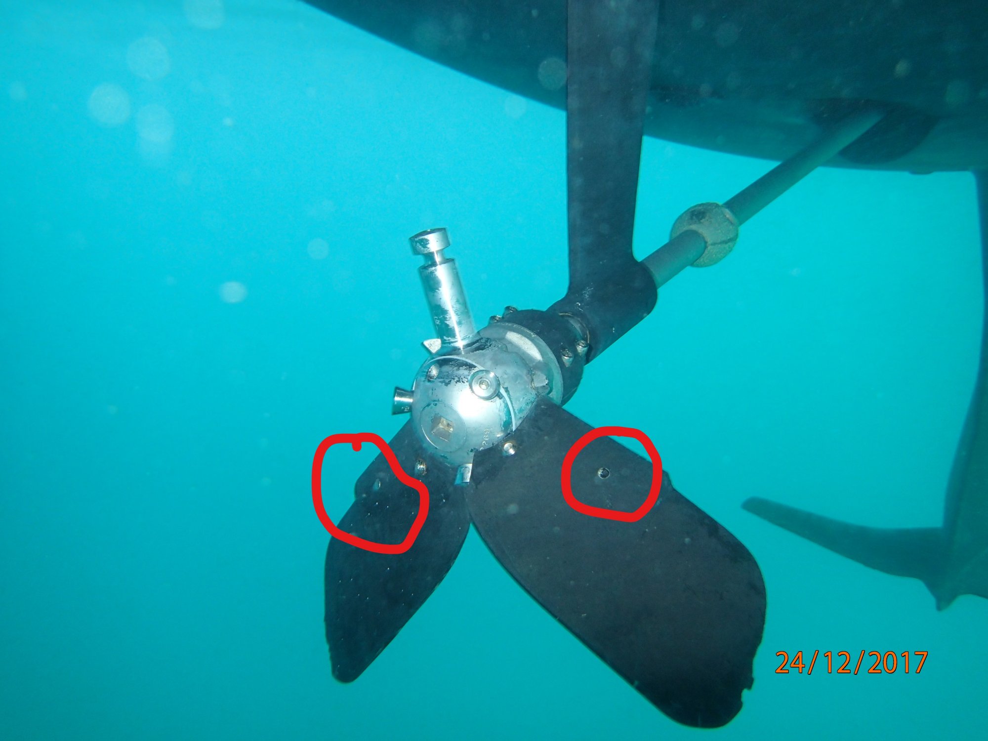

Oct 29, 2005
2,366
I had one of 3 KiwiProp blade dropped off 3 years ago. The captive pin (dowel pin) slide right off after several hours of motoring. Had to motor on with the unbalance/vibration for many hours due to darkness before diving under to replace the missing blade in daylight. Replacing was easy. Luckily the new spare blade comes with a screw locking type pin.
Then just 2 weeks ago, I dive under to clean my KiwiProp and found one of the two older blades with dowel pin came off half way. Could have lose that blade had I not checked. I think the newer design that uses screw locking pin is way better.
Photo show one blade missing and red circles are the Dowel Pin whole the blades.
