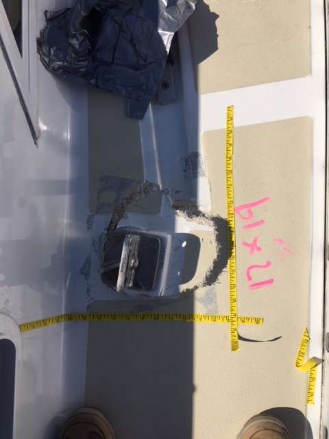

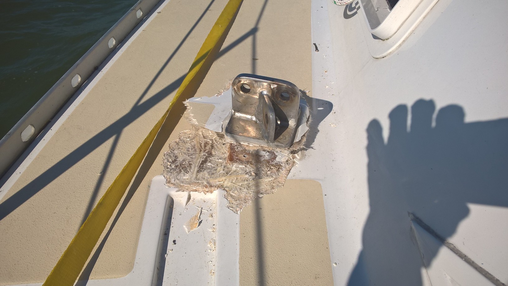

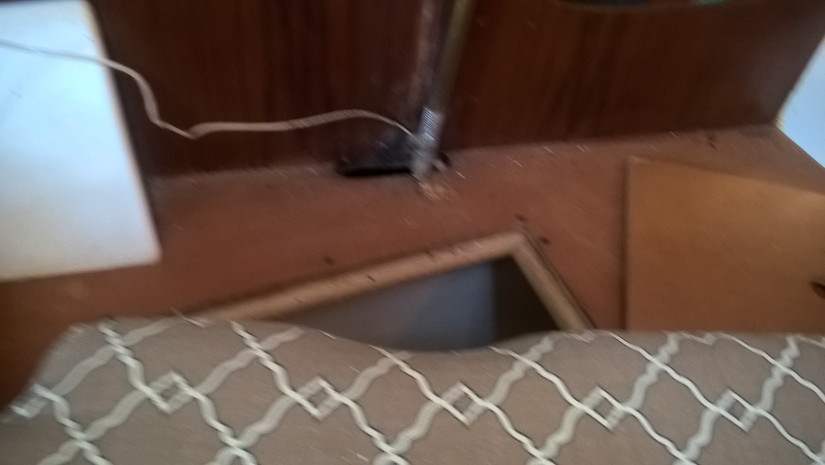

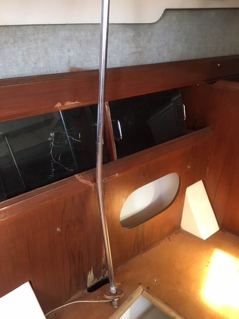

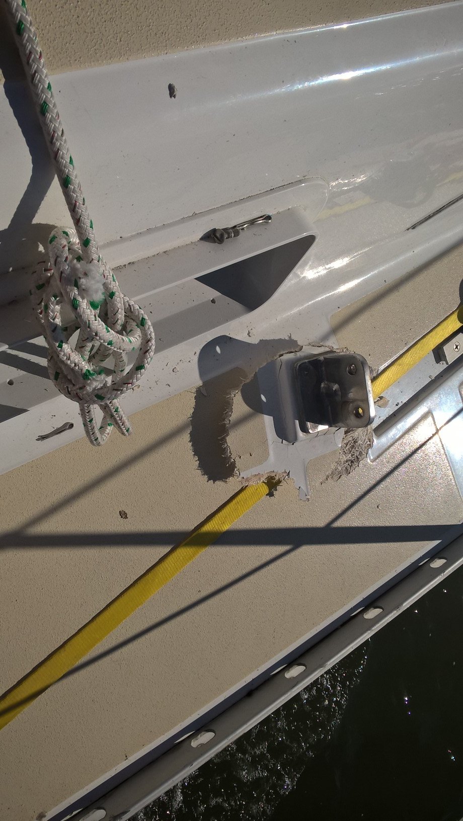

yes rod where it enters the small opening at the connection point. rod broke at this point. attached are pics of deck damage when it pulled up and also in the cabin (the blurry one is where you can see a broken rod)
10,247

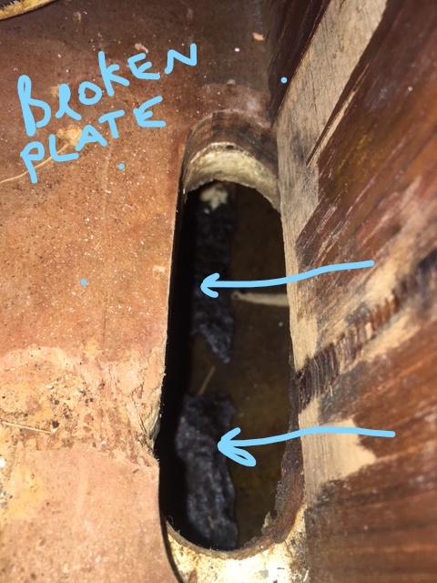

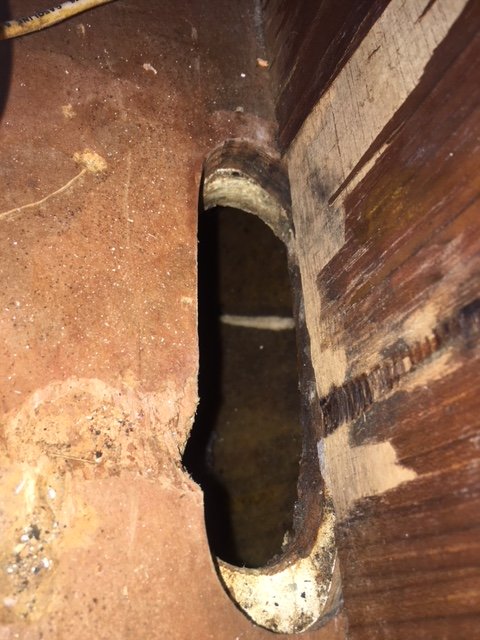

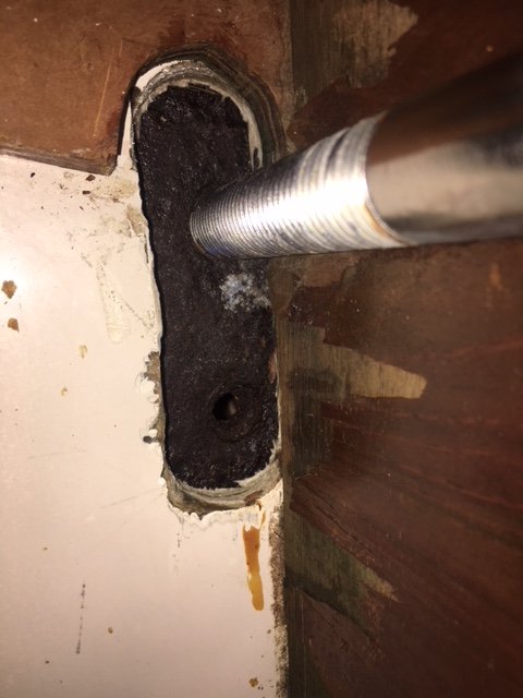

There have been several discussions on this failure and repair here on the forum.. You should be able to find them using search terms like "tie rod" .. Since the loads are high, and the stringer that it is enclosed within has unidirectional glass in its layup, Hunter recommended cutting a hole in the hull for access to the angle iron tie rod anchor.Seems like it should be accessible from inside after cutting a hole through one end of the big beam.. The angle irons were plain steel, so any long term leak of salt water onto the beam there would result in this failure.

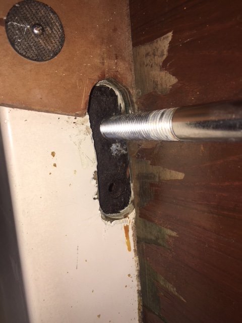

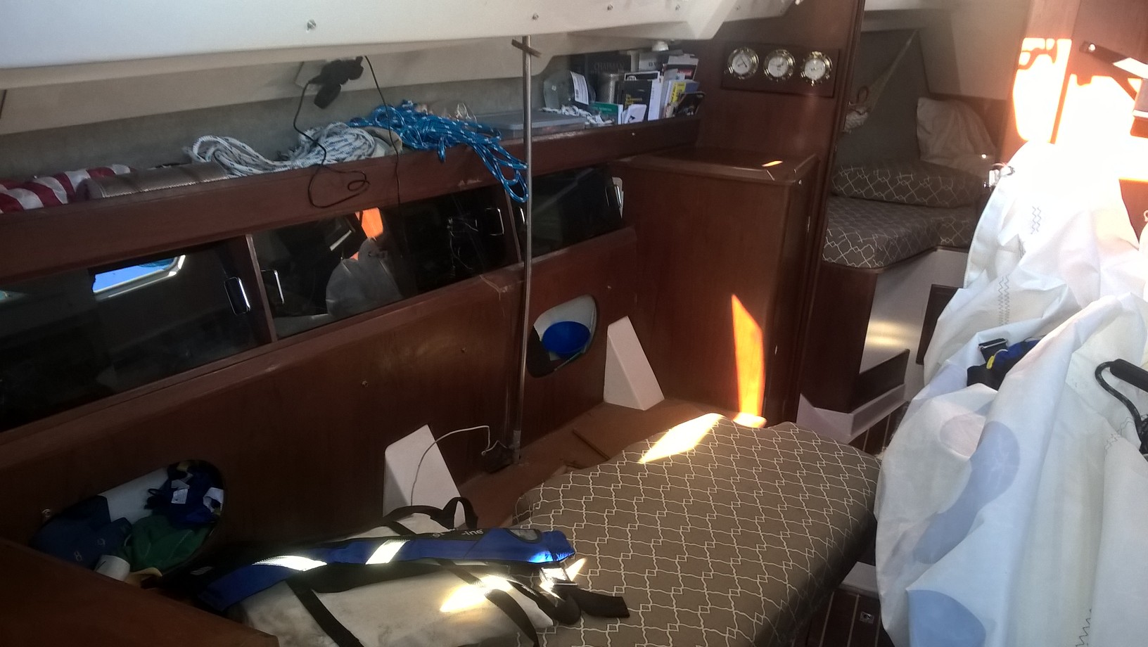

Could you take a picture of the attachment point inside the storage compartment under the bench? I want to see how it compares to what I have there. Thanks in advance.

Kloudie. Agree on the salt water over time. These vintage hunters aren't spring chickens but they're still one heckuva boat. Still looking at possible fixes and I do have the pics and info off the forum from a H34 years back in the Caribbean and what he did for a fix. Really don't want to tackle this from the outside and will work some sort of internal fix with an access port for inspecting in the future. Will also add a stainless steel backing plate on the inside where the rod enters the interior and thru bolt that.
Chip - will be at the boat this weekend and take a few pics for you. We should have the same type of chain plate because this is what hunter used in the mid eighties
Jerry
Mar 20, 2011
624
Hunter 31_83-87 New Orleans
Chip - addl photos for chain plate attachment - pics are of port side where it broke and also what is on the stbd side now. will be replacing this one as well once we come up with the repair method. will take photos of in work process and share.
