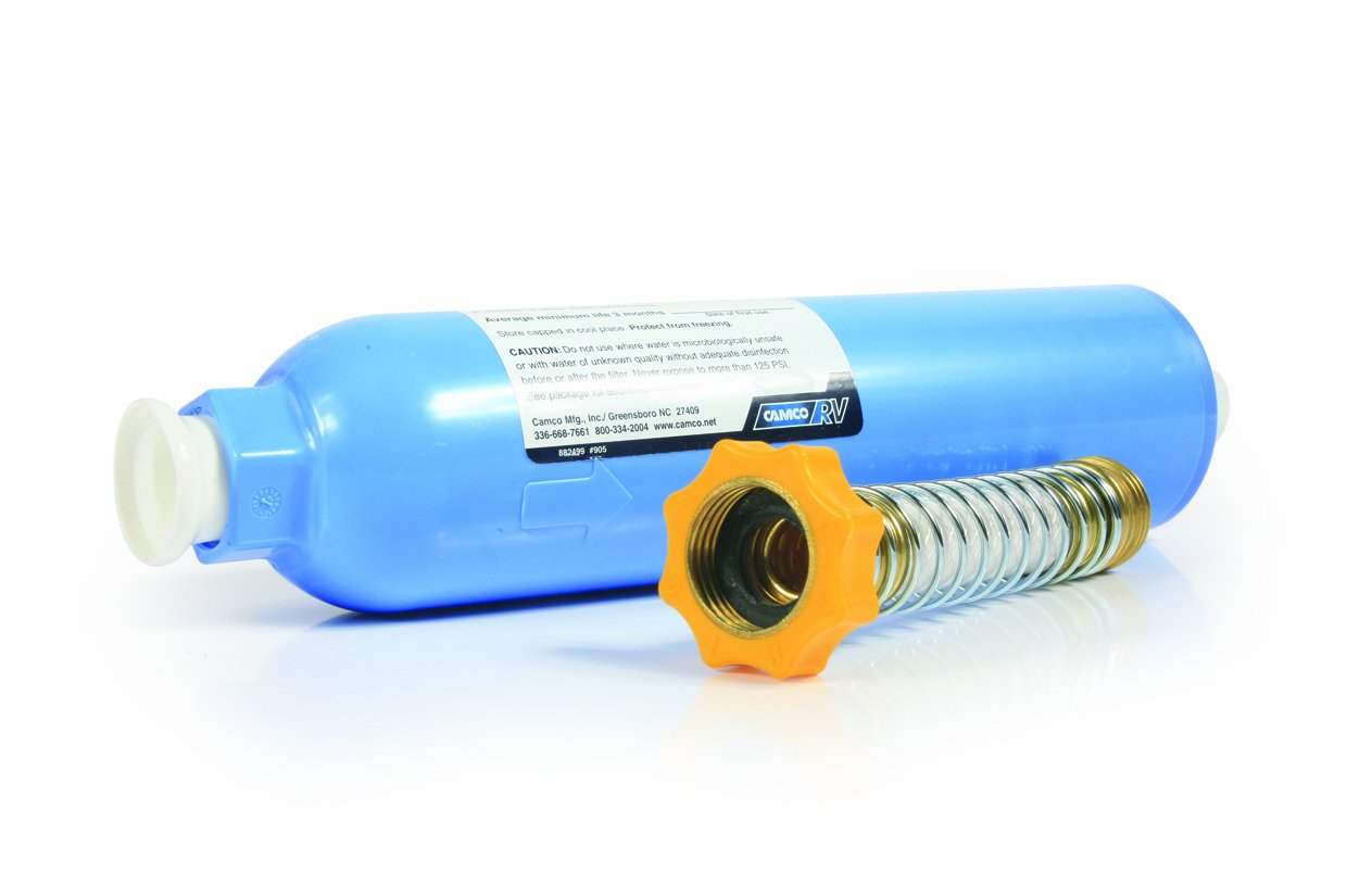

The admiral says our 'fresh' water is smelling like sulphur. I filter it when I fill.

You are taking out the chemicals (halogens) that keep the water critter free. If it is municipal water filter when you use it not when you store it.
Here is how to calculate water treatment for your tank size, both shock and storage.
Technically removing the halogens (chloride Cl-, Iodide I-, etc.) has little affect on the bugs. I think you mean the chlorine (Cl2), or hypochlorite (ClO-), which kill the bugs. It also depends on what sort of filter Justin is using: particulate, lead, chlorine, odor, etc. But you may be correct that the filtering is allowing production of sulfides.

This is the one I use to fill. It's what the PO used. It has GAC (Granular Activated Carbon) filtration
I'm pretty sure that will remove chlorine from the source water. Peggy's recommendation to recommission your fresh water system would be the first thing I'd try.
