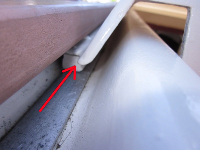

In the pic below you can see the cut and router edge of the slider rail. Ignore the arrow. I was showing someone how to cut down fix a fiberglass to fiberglass wear problem.
The cuts show the dense foam core of the material, which isn't very attractive but the trade off in cost and no maintenance was worth it to me.
2 years and no sanding and varnishing and I still get the wood trim look which is important to me.

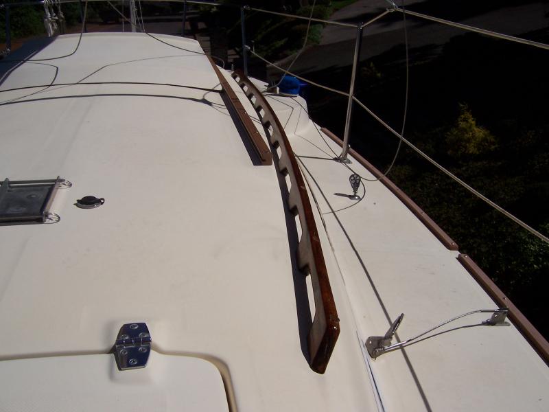

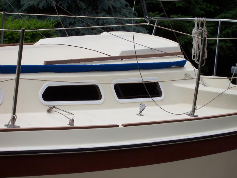

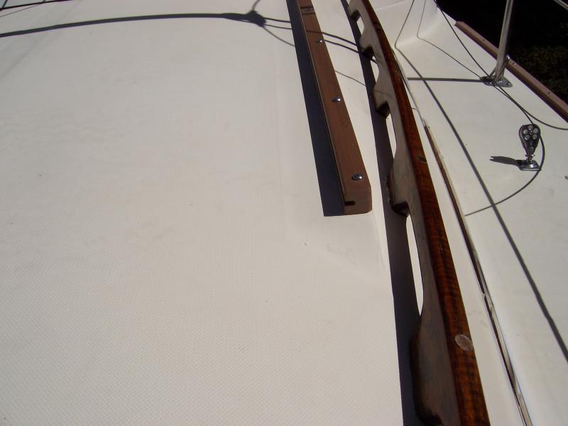

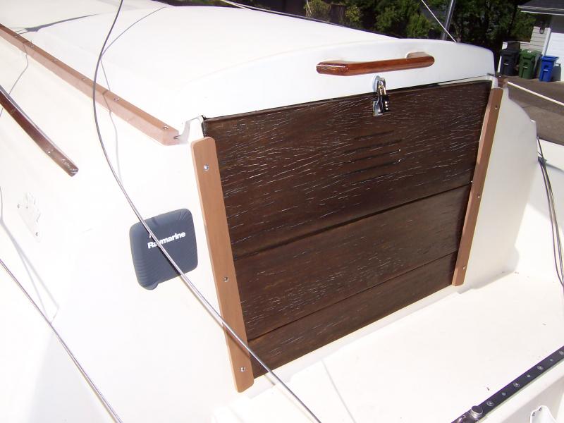

Deck trim done!
Finished installing the deck trim last night. Used Timbertech XLM PVC for the toe rails, hatch slides and hatch board trim. Installed with 4200 and new stainless oval head screws not countersunk. Looks great! The XLM slotted board was perfect height for the hatch slides, so have the factory finish on all sides except the outside edge. The hatch board trim pieces were cut to have the factory finish on the face.

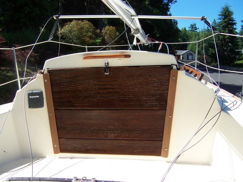

This made the remaining teak hand rails look really shabby. Removed and refinished those and I will sew sunbrella covers for the refinished hand rails this weekend to keep them looking great. We re-bedded the hand rails with butyl tape and put in new oak plugs from Home Depot. Refinished the hatch boards, but they are pretty well shot so need to figure out what we want to replace these with.
We are thinking we may want to re-bed the XLM pieces with butyl tape, but will wait and see how water tight everything is first. Once the four new cabin windows arrive from D&R we will install and then get the boat in the water! Love it!

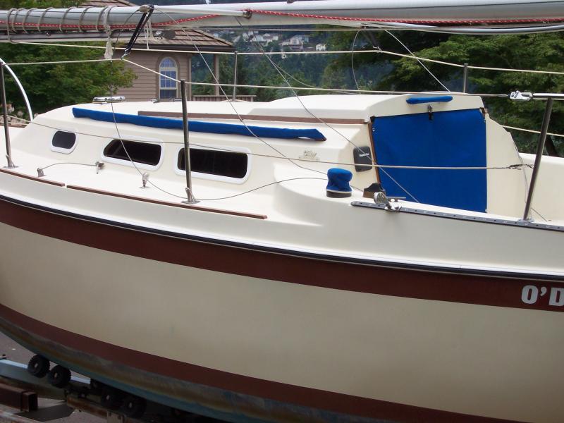

Tabi II is finally ready to sail!
Received the 4 new cabin windows from M &R yesterday and installed last night with DOW 795. Last weekend I sewed covers for the remaining deck teak, except the cleat risers. Photos attached of the completed project (Timbertech XLM PVC trim, new teak trim covers, new cabin windows). Will see how the PVC trim holds up - hoping to get at least 5 years out of it with no maintenance.
Wow, what a difference! I would love to have seen an O'Day 25 new.
We will finally be putting our new-to-us boat into our seasonal moorage at Fern Ridge Reservoir this weekend - then sail, sail, sail!
