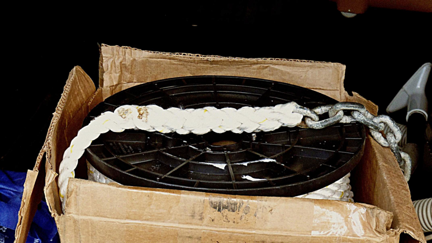

Your picture shows me, time to replace with new. I will never use a repair link on our boat. I've tried all kinds of rope to chain splices and have returned to a thimble and shackle. Replaced our degraded 1991 30' chain with new 50' in 2015. Compared prices with WM. Went with this supplier as they were about 40% less in price for the same brand. High Test – Grade 43 - Wachain.
Went with ACCO brand (Made in USA) hot dipped galvanized 5/16" G4, which fits our gypsy. Even after anchoring many, many times in PNW waters, today it looks the same as new. It gets a fresh water rinse at the end of each cruise.
I’ve reached out to WaChain for a quote. I’m looking for the same chain.
I’ve already priced Defender at about 15% below WM’s sale price.
I inspected the rest of the chain more closely. I’m going to replace the entire thing. It doesn’t seem worth keeping the relatively good section and dealing with a link. If I had 200’ of chain with a longer section in good shape, I would probably go with the upsized link.
