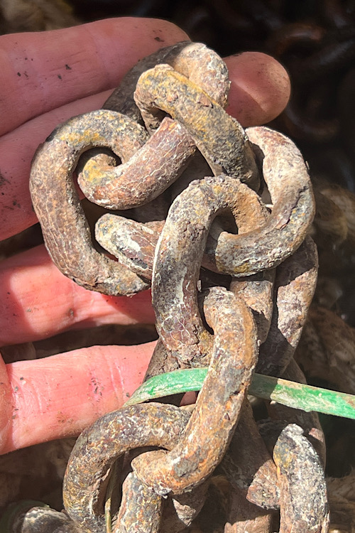

I have 100' of 5/16" G4 anchor chain of unknown age (purchased the boat in 2019), and the first 60' show some sections of corrosion (see image). I've been advised I can replace the bad section with new chain via a "connecting link", but I don't know if this is advisable. I am cruising the waters of the Salish.

This seems to me like a common sense thing. You have 100 ft of chain of unknown age. 60 ft is bad. So why are we discussing ways of saving 40 ft of unknown age chain? Why aren't we instead discussing 100 ft of new chain?:facepalm:

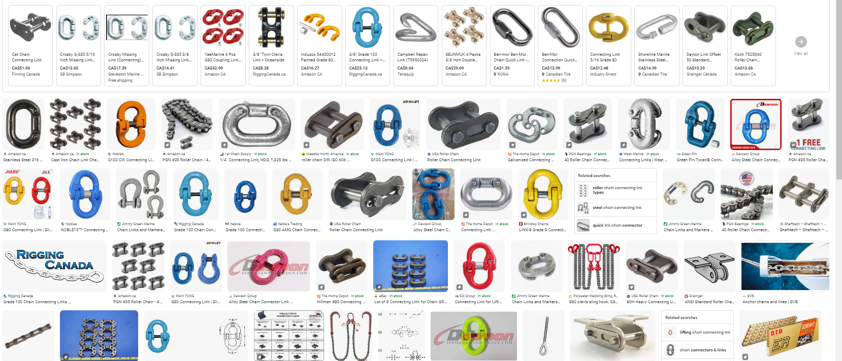

From all the connecting links you can find in a Google search :
................ it looks like the sole concern is to maintain the strength of the original links but not fit through a windlass gypsy. I can't see how it can be done unless your were to weld in a replacement link with exactly the same dimensions as the other links. Such a skilled welder would likely cost you several times the cost of a new 100' length of chain.
I think your biggest problem here is your advisers. They sound as if they're affiliated with the group of stumblebums who wander up and down our docks dispensing their pearls of wisdom to anyone who isn't fast enough to get out of earshot.

There are two fundamental problems with "just welding G4 chain" as a connector.
1) the structural integrity of the welded link.
2) the destruction of the hot dipped galvanizing creating a corrosion problem.
1) - G4 is a high strength carbon steel. In order to weld it correctly, you would have to develop a weld procedure requiring highly controlled weld parameters and to then mechanically test those resultant welds until you found the weld parameters that produced predictable output. The cost of doing this work would be far more than the cost of your chain replacement.
2) - Hot dipped galvanizing will be destroyed in the region of your weld. There is no method to repair/restore hot dipped galvanizing other then sending it to get re-hot dipped galvanized.
In my opinion, it's a fools game to go that route.

I’ve also run across plenty of threads indicating newer chain isn’t lasting more than a couple years before getting fairly corroded. If we’re talking about replacing the entire rode every few years, ($500 of chain and $200 of rope before tax), it seems this could get expensive quickly. Replacing just over half the chain would cost $300, which is $400 less than replacing the whole shebang. I’d hardly call that pennies, especially if it has to be done every few years.
While I don't for certain know why the complaints of chain not lasting, I may have some insights.
With the increased EPA requirements, many hot dipped galvanizers stopped using that process and went to a newly developed process called mechanical galvanizing. Marketing folk loved to make the claim that's it's "as good as" or "just like" hot dipped galvanizing. Unfortunately, that is not technically correct, especially in anchor chain applications.
Mechanically galvanized chain is less expensive to produce so it costs less. The availability of actual hot dipped galvanized has greatly decreased so my guess is those complaining chain doesn't "last like it used to" we're comparing mechanically galvanized chain to what should have been hot dipped galvanized chain. Indeed, in that case the observation is correct.
Make sure you get hot dipped galvanized chain.
Looking at your current chain, I'd recommend replacing the entire 100 feet with bonafide hot dipped galvanized chain.

I‘m with @Rick486 on this one - IMHO the OP should replace all 100’, as the good 40’ of 5/16 isn’t worth that much. It could be upcycled as rode on a rope/chain secondary, or sold or donated.

Really, if cost is the main driver, then simply buy 60 feet of replacement chain and discard the old chain. It's a rode/chain anchor system anyway. I have two anchor systems on my boat, an all chain system and a chain/rode system. My chain/rode system uses 50 feet of chain with 200 feet of rode. There is nothing particularly magical about running 100 feet of chain over 60 feet. Keeping your inspection points to a minimum in my opinion would be preferred. With the rode/chain you have the connection of chain to anchor, connection of chain to rode. And of course you have general state of both chain and rode. Why add in an additional point through a weak link?

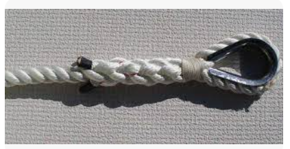

Rope manufacturer's always advise us not to bend a rope around a tight radius in an eye, but include a thimble :
And then then they turn around and teach us how to do this :
It's enough to drive you to a 100% chain rode :yikes: .

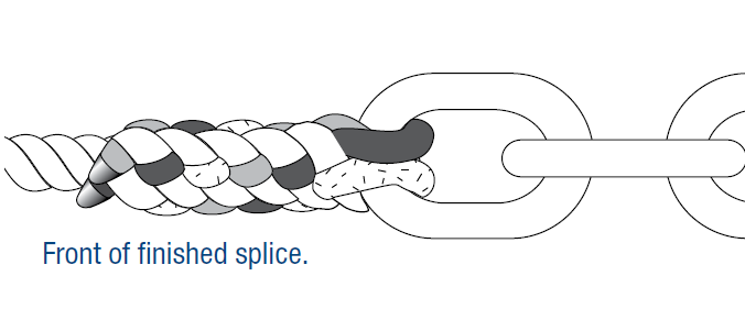

The strength of the crown splice seems pretty relevant to me. What good is the working load of the original chain, and what harm the lower working load of a connecting link if the crown splice is weaker? Does anyone have any info on this?
