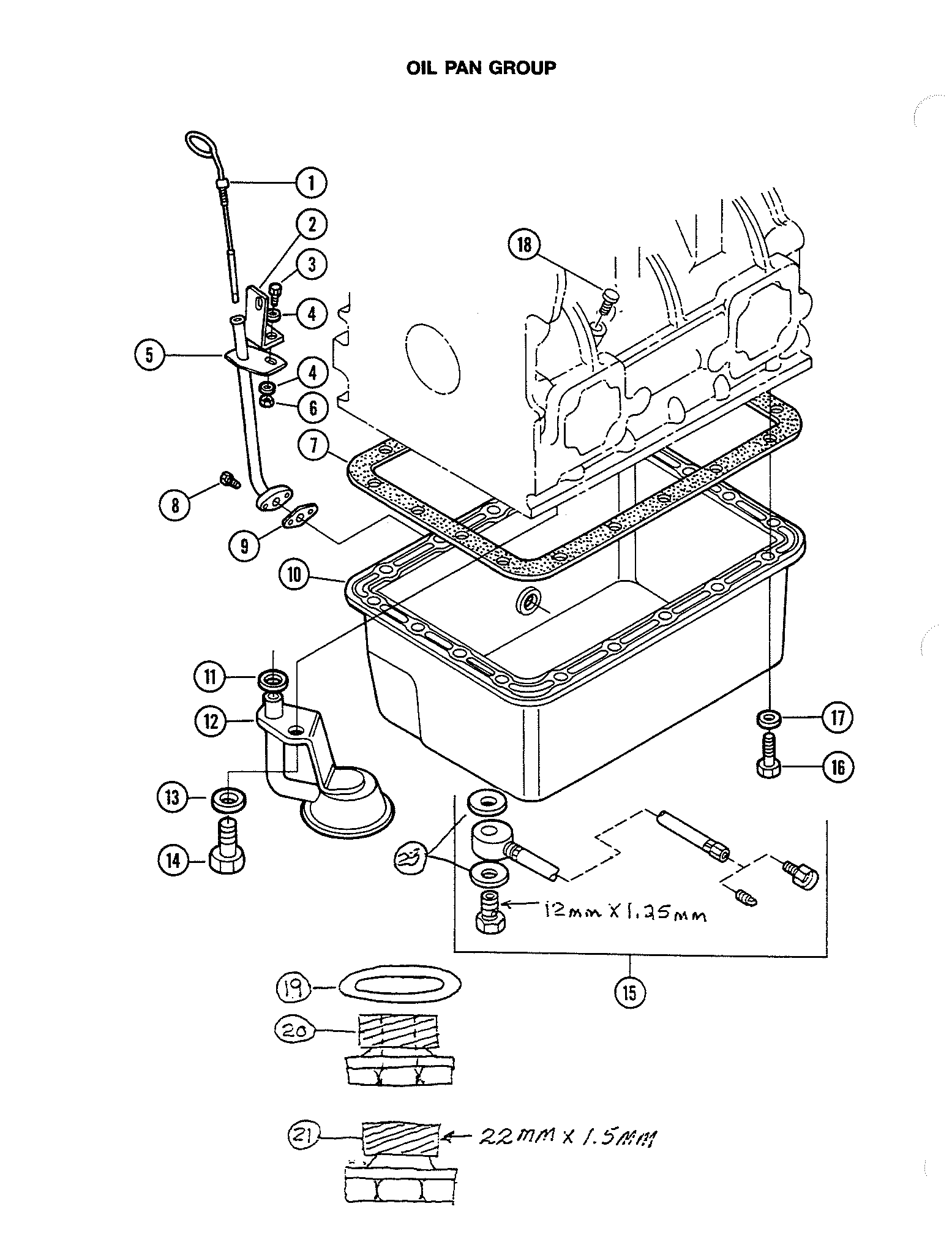

Looks like Leslie is right.. the Universal pan may have the dip stick added and the old dip stick hole is plugged
(part # 18)

10,256
Pick-up fitting is part #12 in the sketch.. goes up in bottom of block and screen sits in the bottom of the pan..
