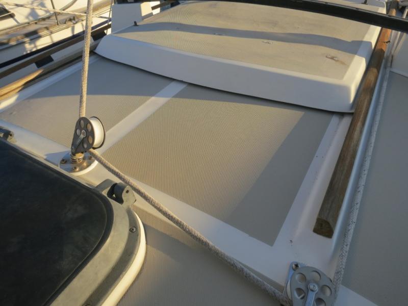

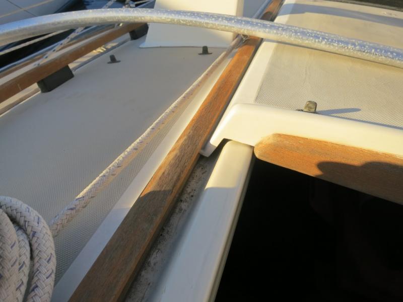

It appears I either have to remove one teak side rail or cut the forward lip off the hatch to have it slide aft and off.
Can't tell from the angles of the photo's you posted, but perhaps you don't need to remove an entire side rail. If you look at your hatch slide as you face the companionway, could you remove just the first couple of screws from each side of the rails to give yourself enough clearance to pull the hatch up and over the molded stopper, and then slide it out?
Hard to describe, so here's a picture of our companionway to try and explain (not sure how similar yours is). I could slide the hatch out by unscrewing the first two screws on each side and gently lifting up the teak rails at the yellow circles. This creates a gap where the lexan hatch can be raised, slid aft and then pulled out of it's track.
If you are to remove it, might be a nice time to try and add a lexan window to brighten things up down below when it's closed.
