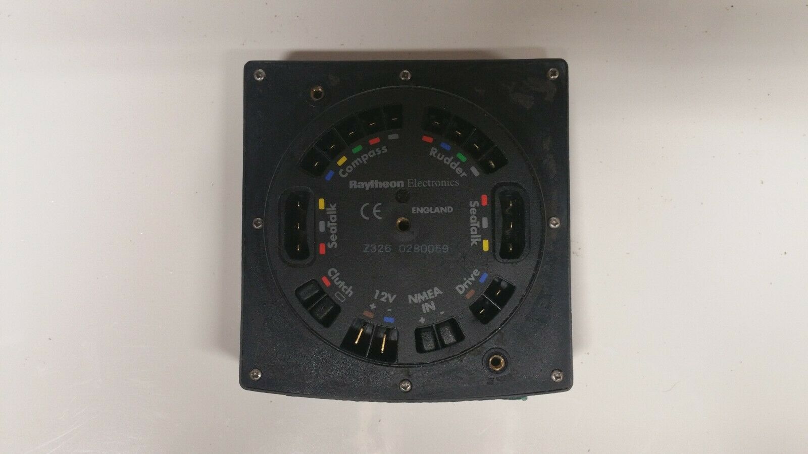

Is your autopilot a ST 6002 or is it a 4000? I am thinking that both control heads have clutch connections ..
The only sure-fire way of figuring out if you can do this is to find out precisely what you have and then get the manuals.

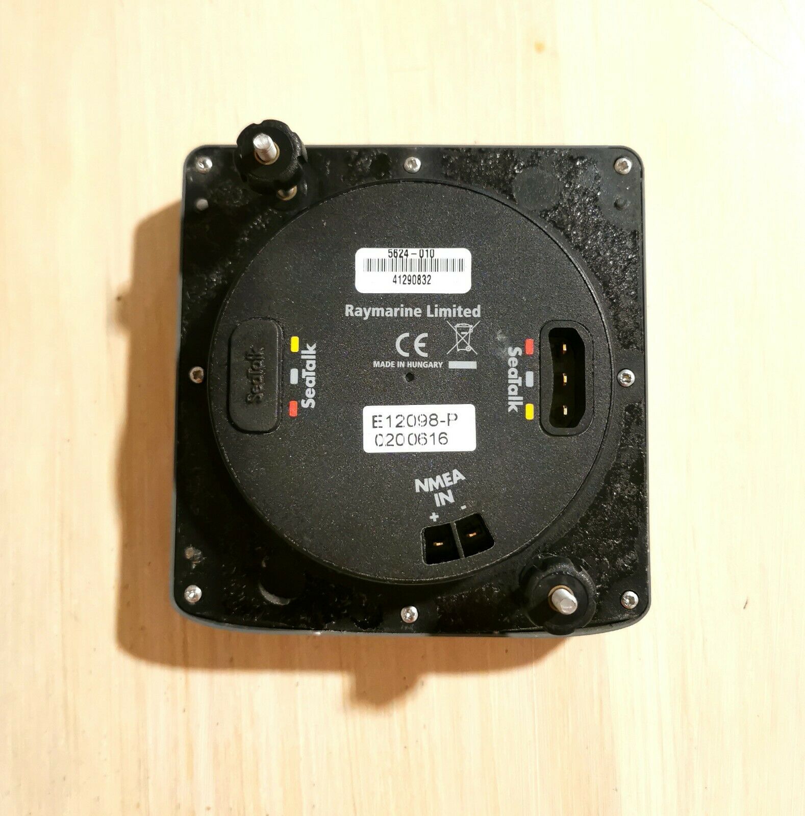

That said, the ST4000+ head was a complete controller, with a clutch output, while the ST6002 was just the control head for a course computer. See these pics:
ST4000+:
ST6002:
