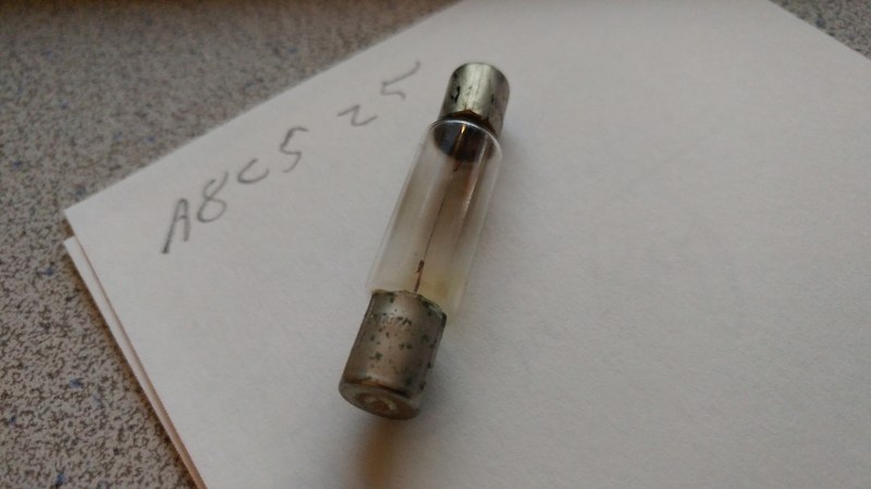

2. Also, I wanted to change the light bulb at the top of the mast. I had some regular 'festoon' bulbs (Pointed on the end), but this bulb has a dip on both ends for the two connections to press in. Reference the attached picture. I've tried to read the numbers on the bulb, but as close as I can make out, it's "A8CS25" or just "CS25". Of course I'd like to replace it with an LED bulb, if I could find one.
A. Any idea what the bulb may be and where I can find it? It's 1.75" long. 12V, 10W
B. Would I be better off replacing the whole mount?
3. The Anchor light (half way up the mast) is burned out and I guess I've just resigned myself to replacing the whole unit (3 3/4" between the mounting holes).

2) Festoon bulbs come in innies and outies (barrell and cone ends) - you just need an innie version. I replaced my anchor light (on the top of the mast) with a new Aqua Signal and bought an LED bulb for it here:
The anchor lights tend to get brittle after 20 years or so (mine crumbled in my hands), so if yours has any age to it, I would replace it (they are only about $25-30, you can swap the incandescent for an LED).
