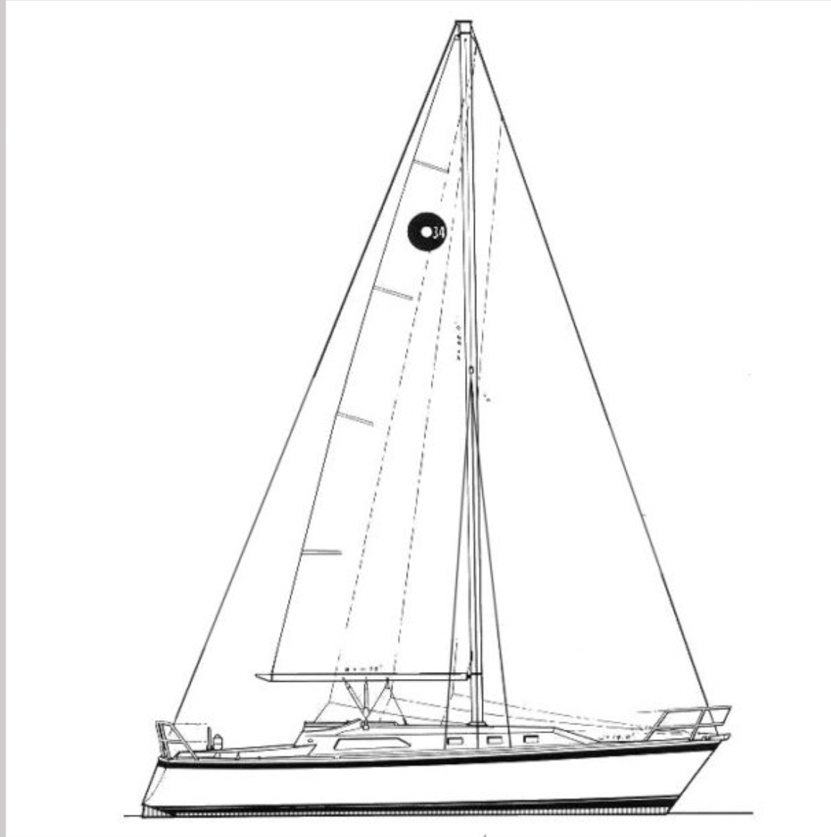

As @Davidasailor26 states, your boat is a mast head rig. The head sail is the primary engine. Looking at the Sail plan for your boat, the image here shows multiple size head sail options were envisioned. Today many owners only want to spend the least amount of money possible on sails. This generates a solution known as a rolling furler. One sail that you can adjust the head sail to provide multiple sized foresails.
