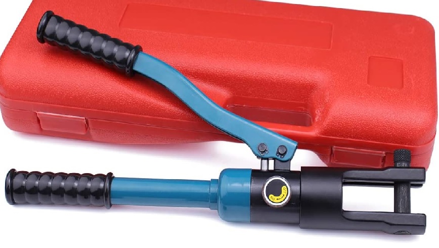

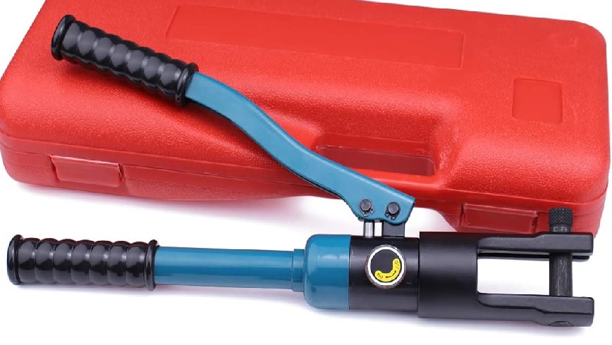

This is a question I have. Can the pipe style be hand swaged or does it require a hydraulic swager? And if hydraulic is required, does anyone know of one that is priced for a DIY project? I have looked at this Muzata brand on Amazon for $139:
https://a.co/d/8iBpuUu
It has replacement dies for about $12 a pair in size 3/16. It seems like a good deal, but I think the cheap hydraulic swagers are better for thinner wire, like that used on staircase railings on dry land. It seems to me, if they were a good solution, lots of sailors would be using them.

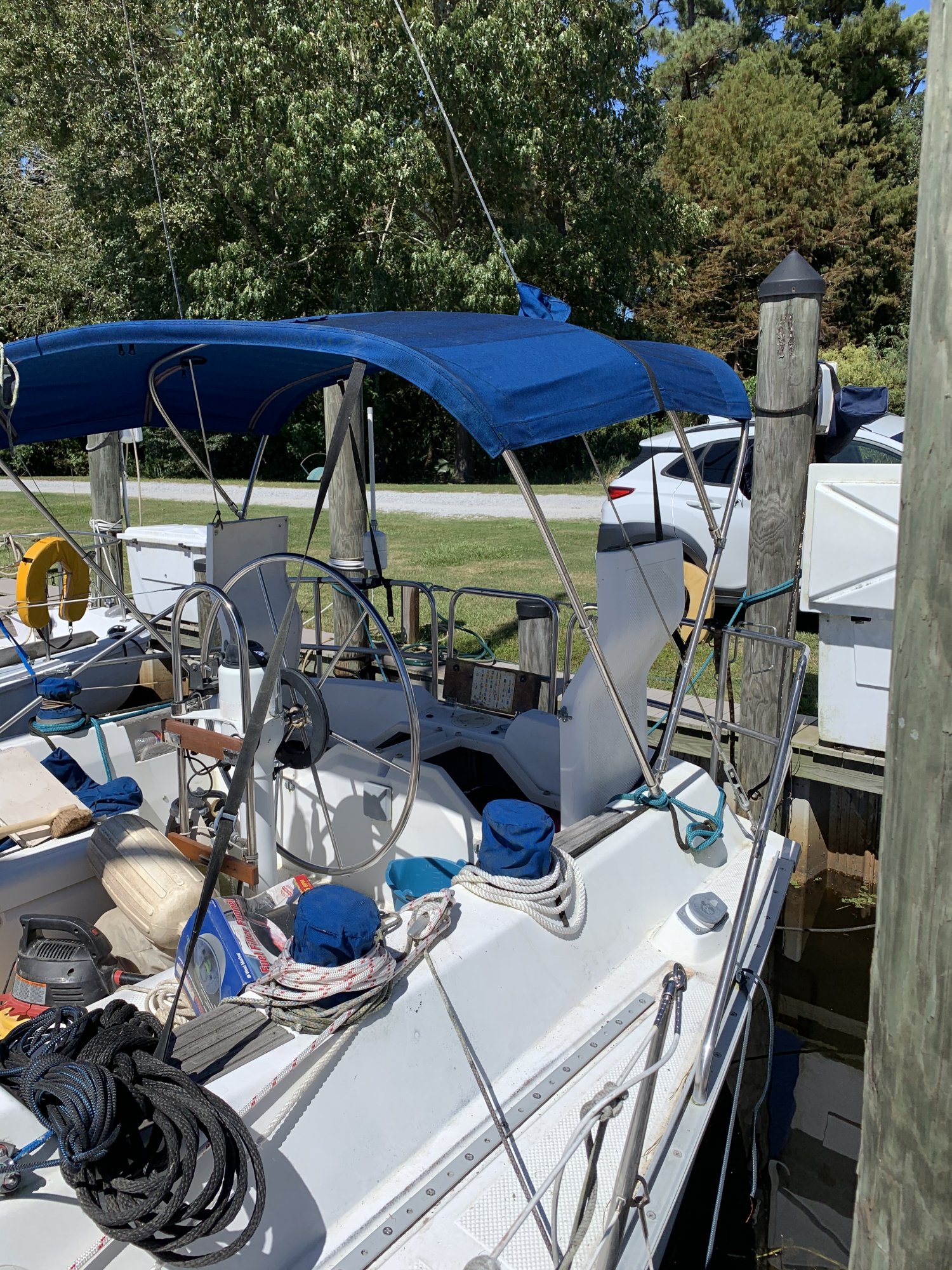

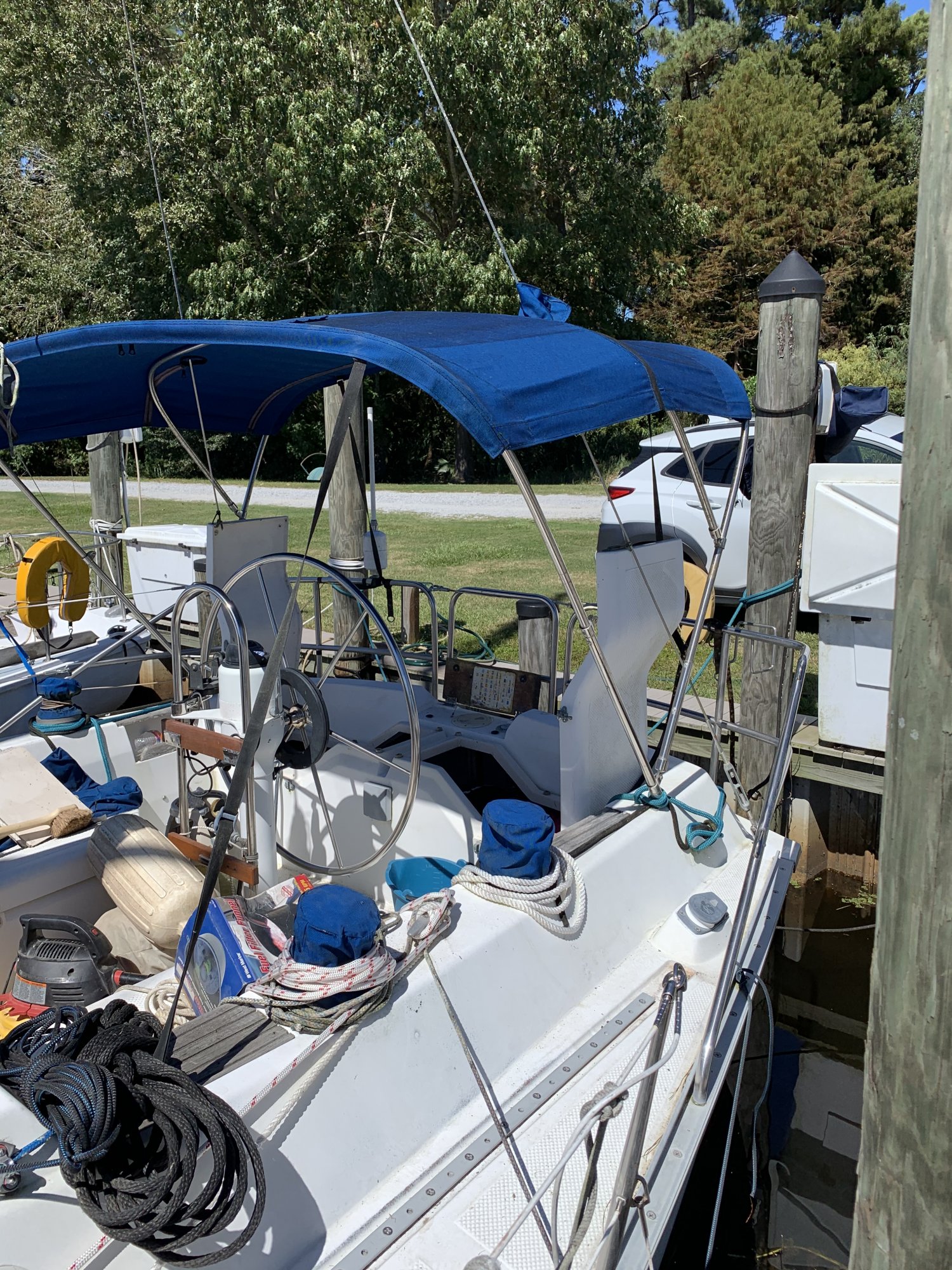

I used thhe same tool as Joe when replacing my Katrina-smitten ones in '05. The swages seem to be as strong as the machine done ones , but they don't look quite as nice. At the top of the stanchion in the mid right of the picture, you can see the hand crimped fittings showing how they have a "wrinkles" from the multiple clamp swages .. I used a drill driver to tighten and loosen the clamp bolts, with a final hand wrench tight to save a bunch of time. Prep of the wire is important, and the ends should be thoroughly cleaned with a solvent to insure that there is no lube in the wire or the fitting. The Johnson fittings and gate pelican hooks are first class. Yup that is a mess in the cockpit!

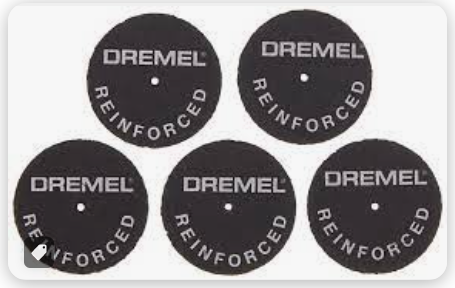

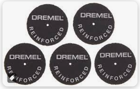

A Dremel with a small carborundum wheel MAY be able to cut the wire. They can cut everything else and they're certainly cheap enough.
This approach works well in my experience. The wheels come dozens to a pack and breaking one is common. Use high speed, hold the Dremel tool steady (it will try to get away from you), cut slowly, and for God's sake wear eye protection. Wrapping the area to be cut in tape is a good idea.
I wonder if you're using the straight carborundum grinding wheels. They can break and shatter and scare the hell out of you. The ones I always use now are about 1 mm. thick and made of woven fibreglass mixed with coarse carborundum.
You can bend them in half and destroy them but they won't break apart.
I think you are correct. I'm so used to them disintegrating that it doesn't alarm me anymore, and they are so cheap that I don't really care. I should look into getting some of the ones you describe, and thanks for making me aware of them!:cool:
Remember to wear eye protection when using those.
I had one shatter and hit me in the face and chest…yes, it scared the hell out of me!
I had planned to add a gate to my lifelines. Upon some investigation, the cheap hydraulic swagers you see on Amazon are crap. The dies are not well made and most are the wrong size for lifelines. If you can find a good quality one.. aka not from China, it will likely much more expensive.
I would feel better using a manual one from Johnson along with their matching fittings.
