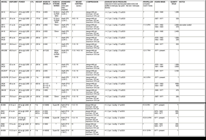

The equivalent Kubota model is a D-1005E according to the attached chart.
