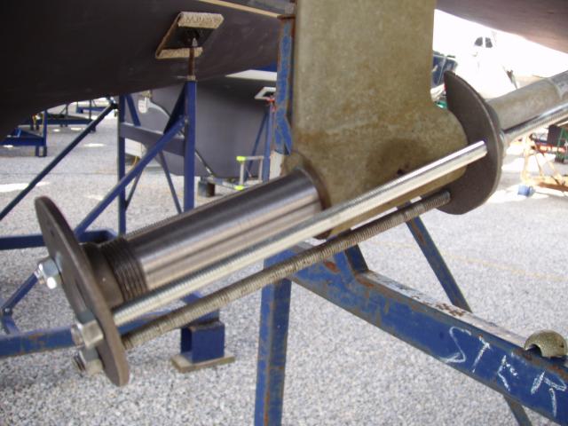

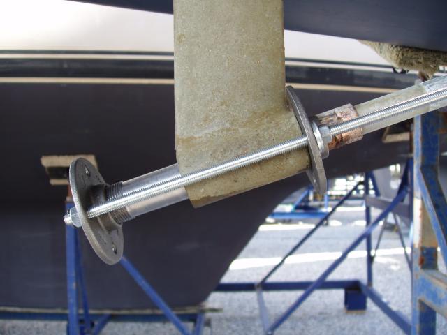

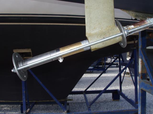

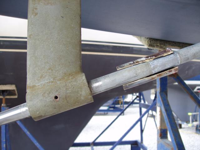

I did it today in less than two hours
Got the parts from Home Depot; a 1" PT black steel pipe. two flanges, and two 3/8 threaded rods. A little of hack sawing and grinding.
Total cost; $80 for the cutless bearing, $50 machine shop, $25 home deport parts.
This is standard 1" Pipe Thread pipe you can buy from Home Depot. Have a machine shop to lathe it down to a little less than the bronze strut. A lot of patient and you saved a king's ransom.

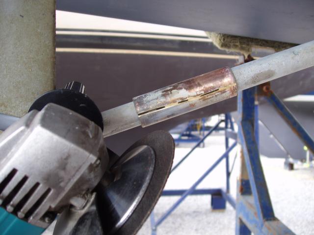

Split the pipe would cost more than double to make by the machine shop. In order to retain the exact circumference, they have to use two pipes because there is thickness of the metal band saw blade. If you just cut a pipe and hose clamp it back, it won't fit anymore.
Since I don't plan to re-use the old bearing anyway, it is easier to cut the bearing off.
