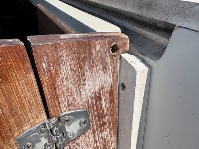

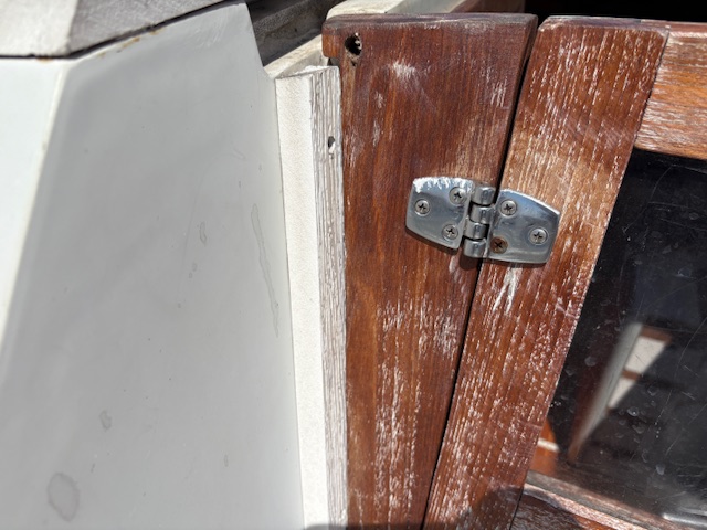

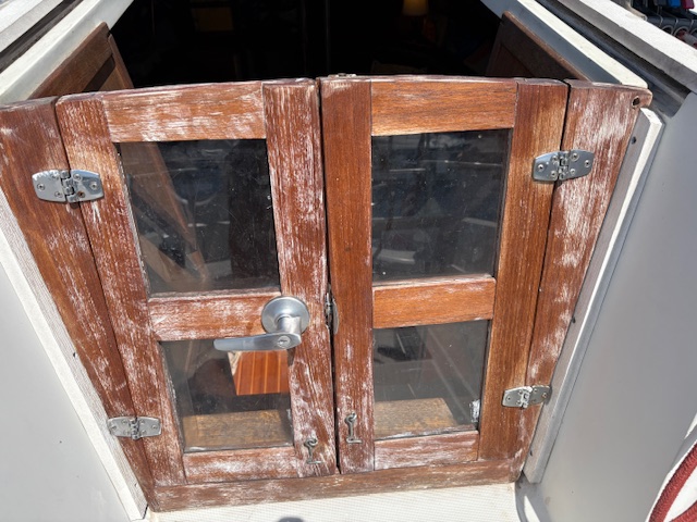

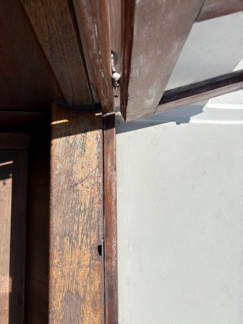

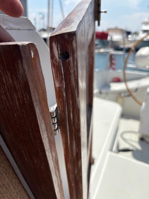

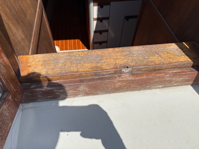

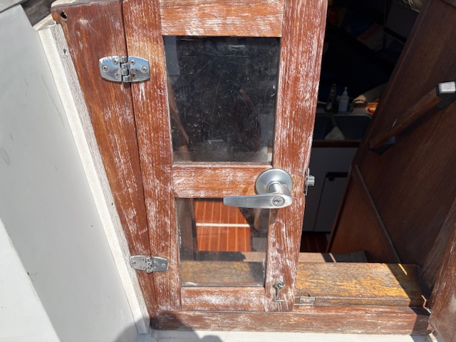

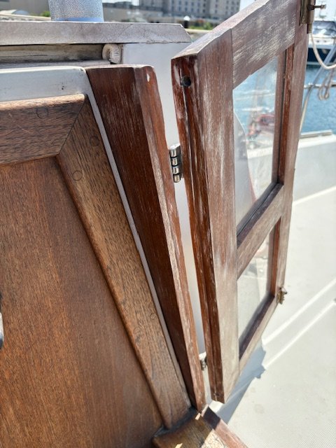

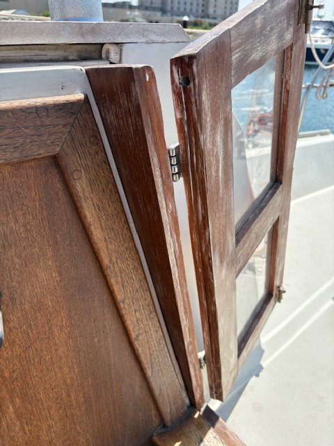

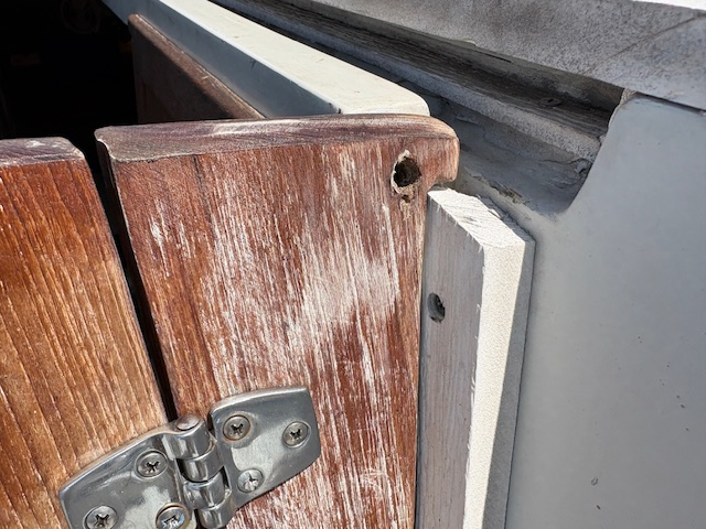

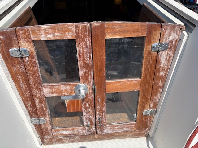

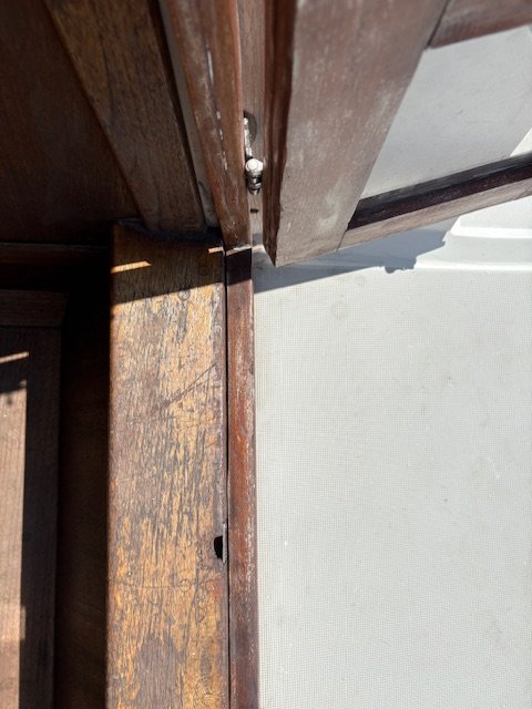

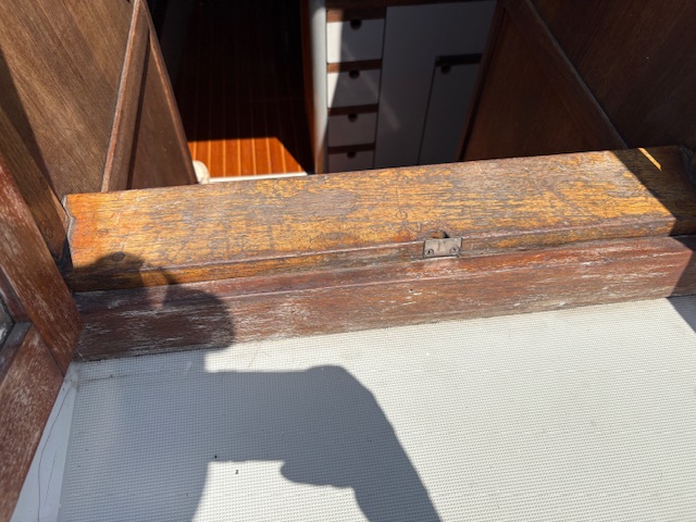

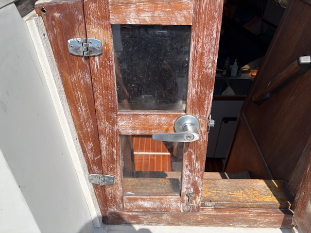

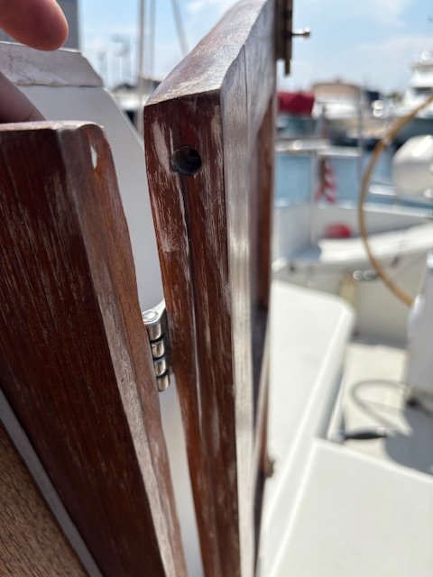

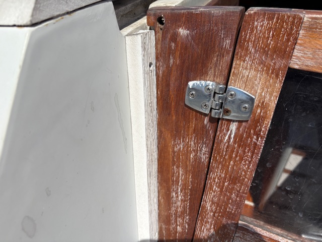

Here are a few close-ups of my home made hatch doors.
IMG_4453.jpeg They look like crap after I painted them white for a few years…and then tried to back to teak…
IMG_4449.jpeg IMG_4455.jpeg IMG_4454.jpeg IMG_4452.jpeg IMG_4451.jpeg IMG_4450.jpeg
Greg
