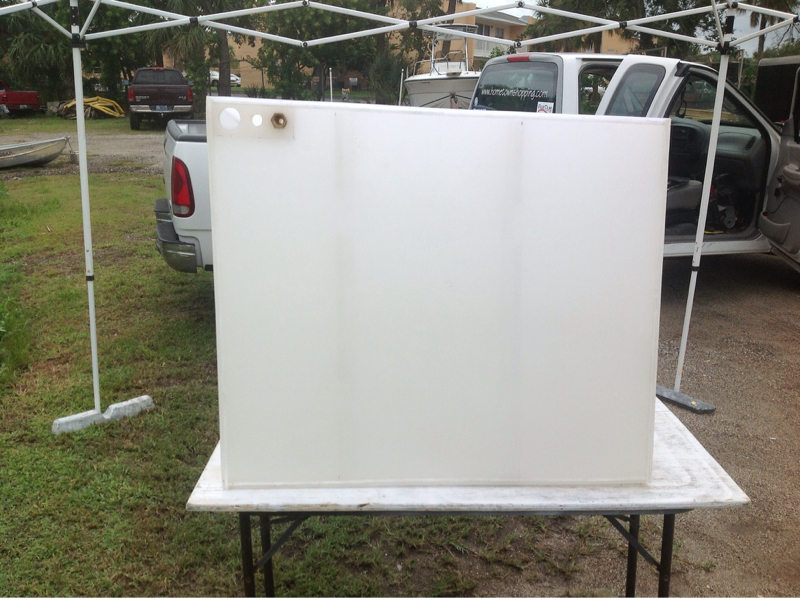

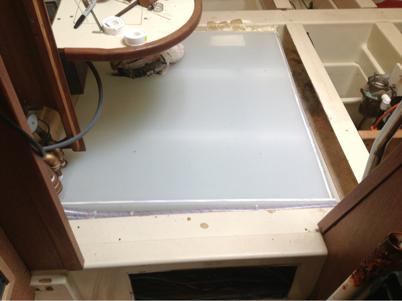

I didn't get an inspection port, never thought to ask, but I don't think it's necessary to have it. You mentioned you are filtering the water going into the tank so that would be 50 years before you might need such a thing. As far as making it smaller, mine fit perfectly with the height no problem and an inch to inch and a half around the sides. I used the cans of insulating foam from Home Depot to secure it back into the hole from wince it came. I vented the tank into the sumps near the compressors because you can't put the vent high enough to use the old vent. They forgot to tell me about lowering the vent and I got a crack in the top seem when I over filled the tank to the original vent height. Easy to fix with the welder they sent me to fix it. Actually very interesting to weld the plastic something else to put on my list of experiences. Anyway, vent has to be lower and so can't go overboard, has to go to the shower sump near the refrigerator compressors. I bought all new brass fittings to put on the tank, didn't reuse any of the old ones, not that expensive. I relocated all my water stuff, pump and reverse osmosis filter in the cabinet next to the chart table, didn't put the bottom back in the cabinet. Also since the reverse osmosis wastes so much water in the final stage, I put the waste water from the filter into the water tank since it's been filtered and purified with charcoal, hated to send it overboard, good enough to shower and use for other things, just don't use it to drink unless it's all I have. Can't stand the taste of dock water with out the four stage filtering. Did they keep the dimensions to my tank? Hope so, fit was perfect. Jim

Wow Jim, great looking job. It looks like you did something like a barametric loop for the vent line then ran it back to the shower tank. The other thing I noticed is it appears they provided a thickened area for threaded connections into the tank. that is where you put on your new brass fittings. but the pick up had a fitting on it already and I assume that is for the line that goes to the opposite lower corner for the full use of the tank. Did they provide that or did you do that portion of it. And do you remember how long from start to finish it took you to complete the job? Interestingly, my water pump is on the other side of the shelf wall. I am really getting excited about this project so excuse me if I ask too many questions! Sandy

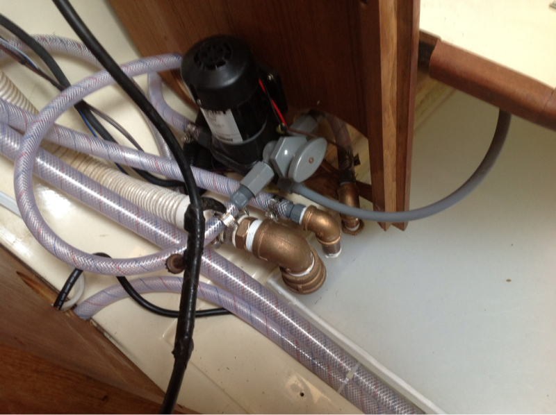

Actually, I took that picture before I rerouted the tube to the shower sump. The pickup tube was already installed in the tank, you have to furnish the rest of the fittings. I relocated the pressure pump because it was too crowded by the water heater. Put in new heater and rerouted all the water lines. I enjoyed doing it, like I said earlier, lots of experience, money not so much. Anyway it wasn't an impossible project like some can be. I ended up using the cabinet you see for the water pump and filter system. If you have any questions, just ask. If you would like to speak, cell is 386-451-2494 or email to gm@harbourbeachresort.com Jim

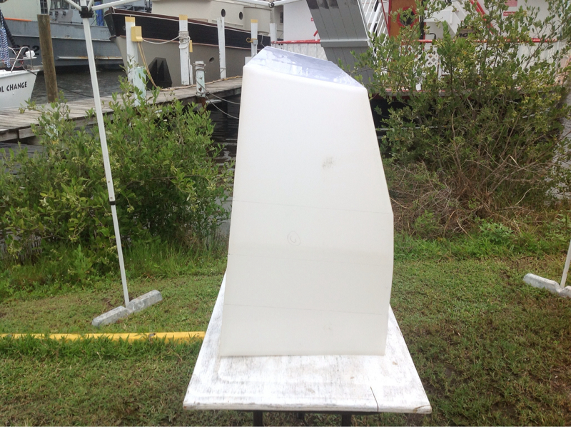

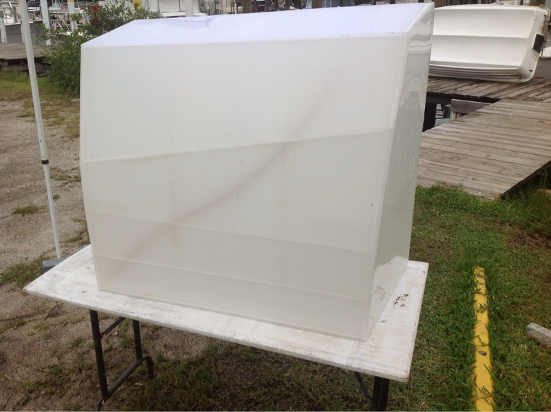

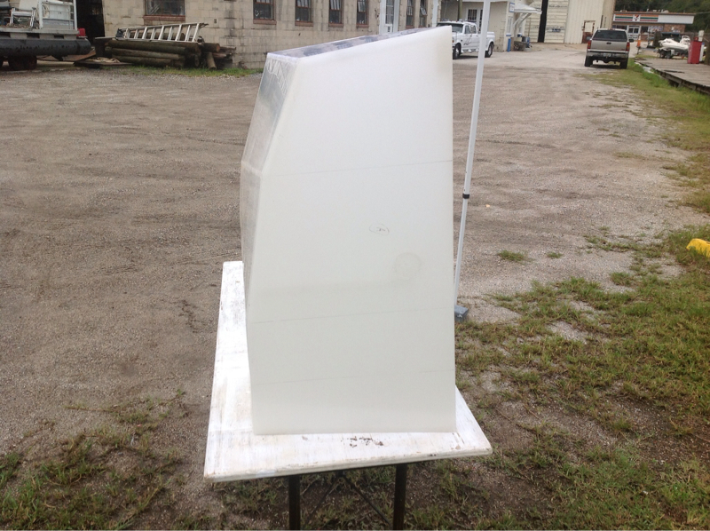

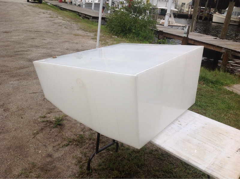

Thanks for the great information and AWESOME photos. Really excellent job at detailing how to perform a major job. The photo of the new tank sitting underneath the settee is worth a thousand words.
