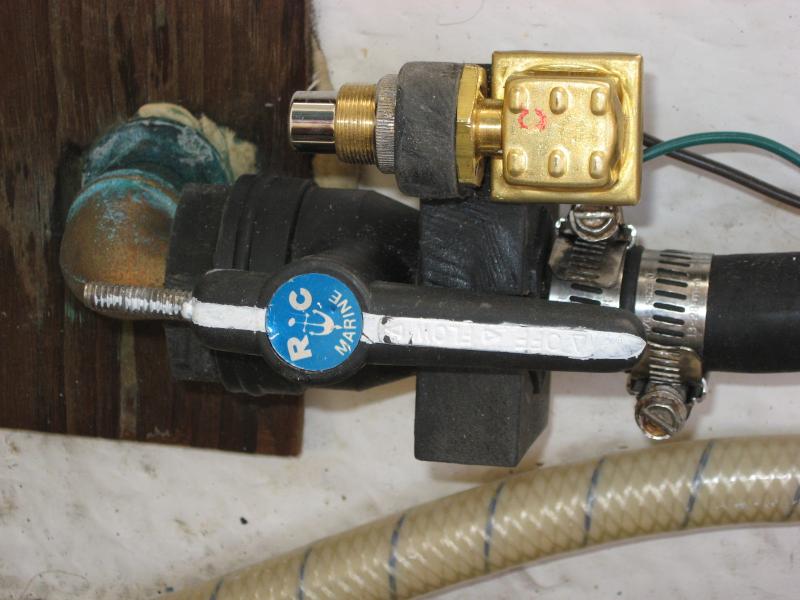

My boat has a mixture of bronze and Marlon on each thru-hull.
I have had no trouble with the Marlon valves themselves except for the very large one for the galley sink drain which I plan to repair at my haul-out next month. When shut, it is water-tight. But when open it leaks a drop every so-often. A new o-ring on the valve stem spindle should fix I've been told. The engine raw water valve is opened and shut several times per week for the past seven years and shows no signs of fatigue. However, I have been thinking to replace it at my haul-out in May ... just for good measure since it is used so much. The huge Marlon valve for head waste is always shut (and capped) since a higher end porta-potty does fine for our day outings and the occasional overnight.
Best I can tell, I believe the actual thru-hull fittings are probably Hunter factory original. Bronze with plywood backing plates. A P.O. at some point replaced all the valves with Marlon by threading into the original thru-hull threads as in the attached picture of my engine raw water thru-hull/valve. At my last haul-out several years ago, from underneath, spot scraping here-and-there revealed only healthy yellow brass. Same on the hull interior part of the fittings. The plywood "backing plates" are never damp and show no evidence of softening. I hope to see again nice yellow brass on the bottom side.
In case you are wondering about the DIY switch contraption mounted on my raw water valve. It's a "forgot to open the seacock" alarm. My Yanmar warning buzzer had an unused input that I utilized for the purpose. I only once forgot to open the seacock. And after I installed the switch to ensure I wouldn't the mistake again. I was fortunate because my engine was a raw water cooled type that was converted to self contained cooling, it still retained the 140 degree thermostat. I was able to shut down the engine before any real damaging heat happened. Might have been a different outcome if I had a normal 170 degree setup.
