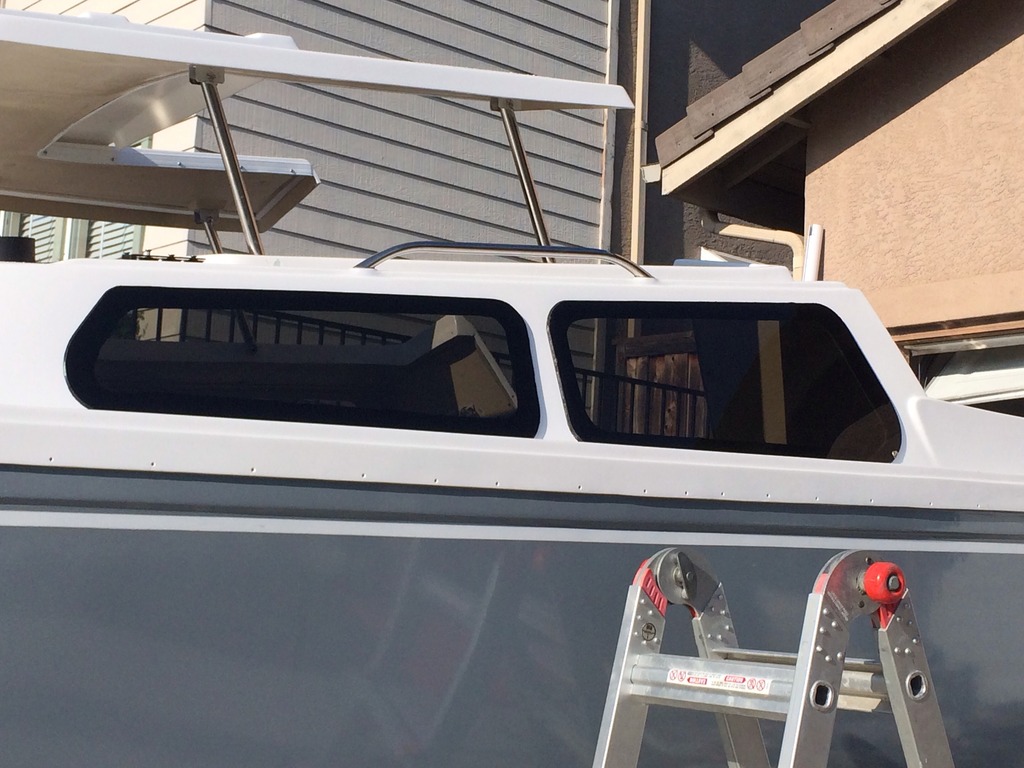

I did this job on my C22, it only cost me $100 to buy the plastic and I cut myself. I did use 3M VHB tape but I shot myself in the foot with the process I used; The pro's will paint the inside edge of the window black because usually VHB tape is grey and you would see the grey tape through the plastic. Mine is as dark of a tint as they have available in Lexan but you can still see through it. The black VHB tape Andy uses in the Boatworks Today video is only available in 3/4" or 1 inch, mine was only 3/8 wide and Grey. Anyway, I wasn't sure about what kind of paint to use and I wan't confident the paint would stick to the smooth Lexan. So I though I was smart and I knifed a very thin coat of the Dow 795 to the bonding lip of the window. This seemed like it was going to work great until I discovered that the 3M tape will not fully stick to the cured DOW 795! I had to think fast so I ended up using just a few screws that firmly held the window in place (still using the 3M VHB tape as a gasket to maintain spacing) and I caulked in the 795 around the outside edge and then also on the inside. When it was cured I took the screws out and put just a dot of 795 in to fill the holes, it came out fine and the 795 is doing all the work. Note, my 'bonding edge' or perimeter of surface contact was 1.25 inch all the way around. Kinda overkill, I should have done it only 1 inch, but it still looks good.

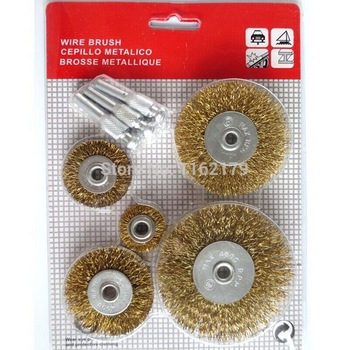

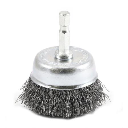

I found these items at my local hardware store. Thin brass wire brushes that mounted into the chuck of a rotary drill. Used carefully they make extreme short work of any rubber bonding/sealing compound. Use a variable speed drill to keep the revs low.
Used not so carefully they will remove skin as well! Don't ask...
