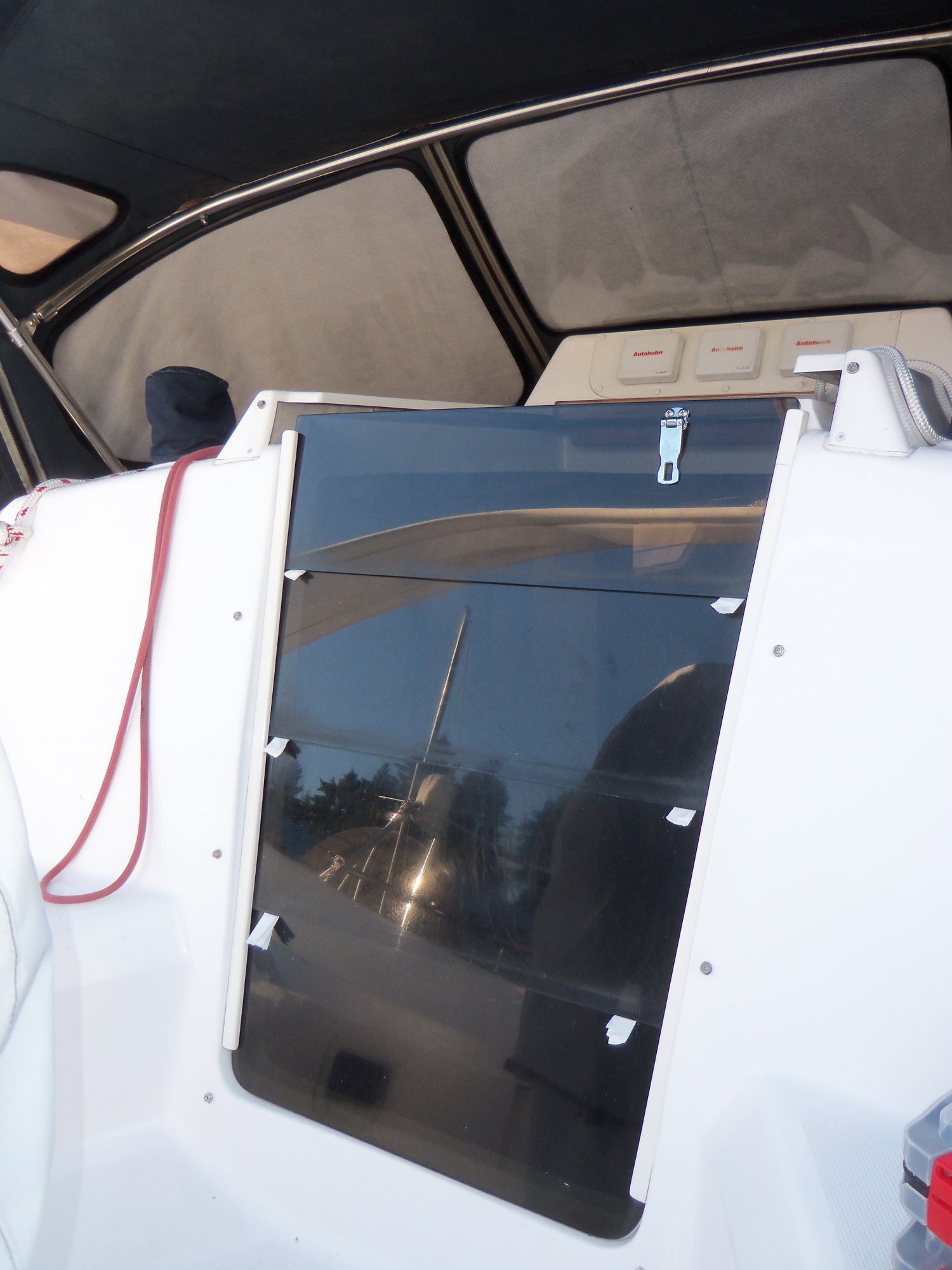

Always best to attach a photo to better describe the part you're discussing. I'm not familiar with a teak sliding hatch but have both the hatch cover and hatch boards done in 1/2" acrylic.

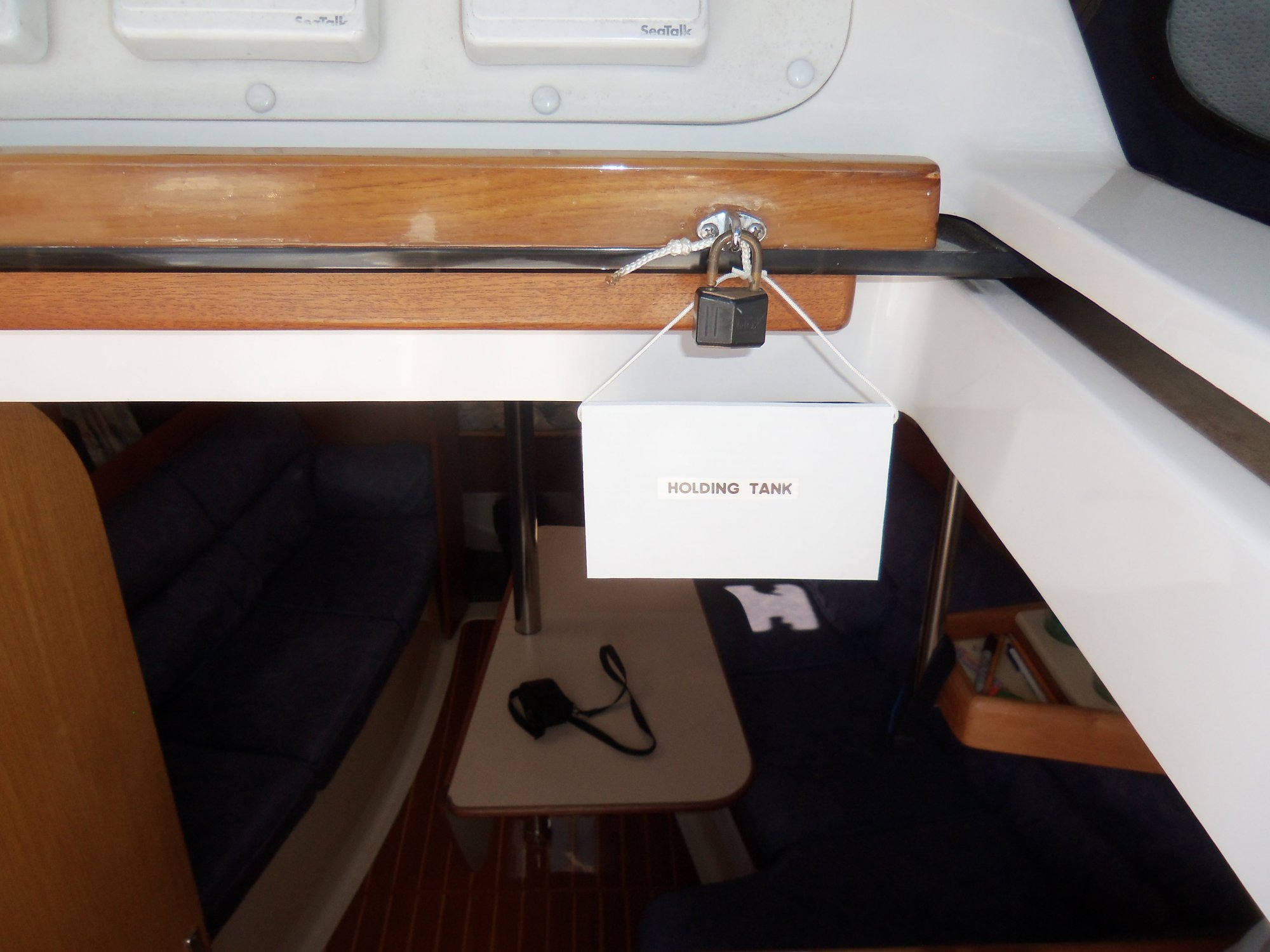

Second photo is poor and only shows the edge of the acrylic hatch cover.
If your construct is the same, no reason you couldn't replace the teak with acrylic.
