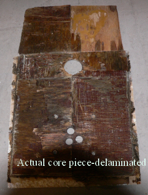

If not already considered, a small item which I learned only after re-coring my cockpit sole:
If possible make the new floor with a slight upward convex curve. Water will then run nicely into the scupper drains and not puddle around the pedestal base.
I re-did my new floor flat. Result:- With the weight of the pedestal and the small squeezing together of the top and bottom FRP skins by the pedestal base securing bolts, I get a 1/16" or so deep puddle around my pedestal base always when it rains. Everything in the core is now very sealed with epoxy and caulk so future rot is not a concern. But would be nice not to have the puddle.

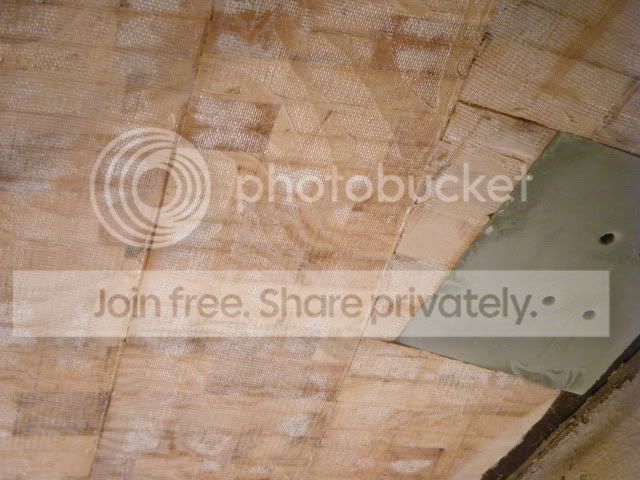

Pics of pro job done on my cockpit sole. Plywood is 3/4" thick. Balsa Core in forward areas, plywood in back. Keystone glass area is about 1-1/4" think. Only penetrations are in the keystone solid glass area. The whole sole is extremely solid. I doubt that it will ever need repair again. Boat is a 1985 C&C 29.

Thanks for the pics Wed, though I do hope to avoid going in from the top :doh:
