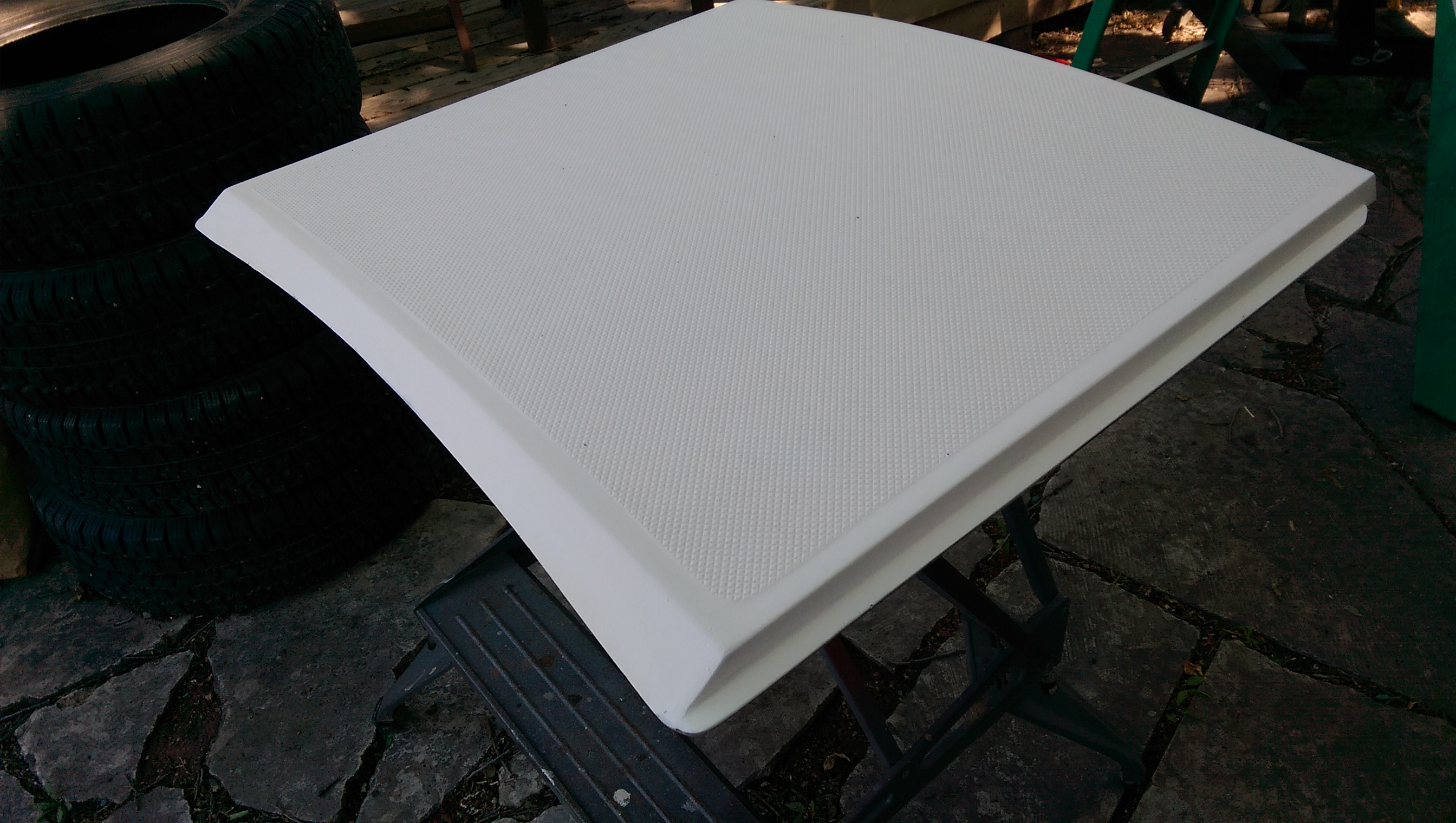

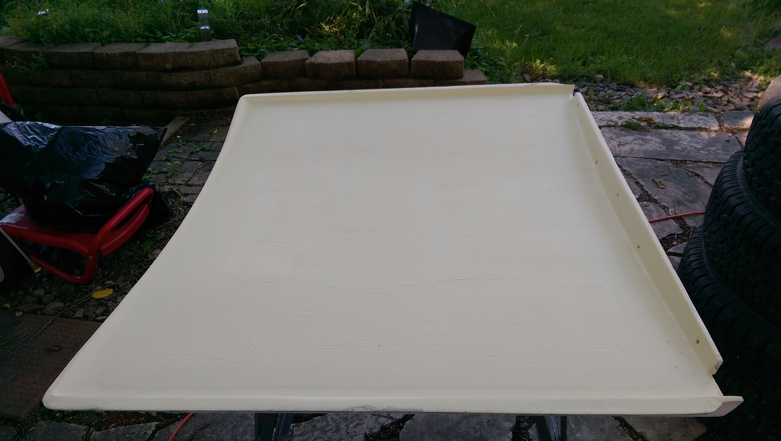

The hatch repair itself worked out as well as I could have hoped.
The gelcoat turned out not bad, but not great.
You can't tell from the photos but both sides have "orange peel".
The bottom, which had slight orange peel, is acceptable IMO, due to the fact it has a textured surface already.
The top, IMO needs to be wet sanded and buffed in the smooth areas around the edges.
I assume it should flow out and end up shiny, so I assume I got the viscosity wrong.
I used Preval sprayers to apply it, just like @Gene Neill did for his hatch repair: Sliding hatch "lips" cracking
I used a waxed white gelcoat available from the local marina store, which is sold in a "bush on" viscosity.
Having never done this before, I thinned the tinted gelcoat with styrene, simply by eye.
(I had called the manufacturer to get some advice but they had never used it with Preval sprayers before, so could only give me rough guidelines)
