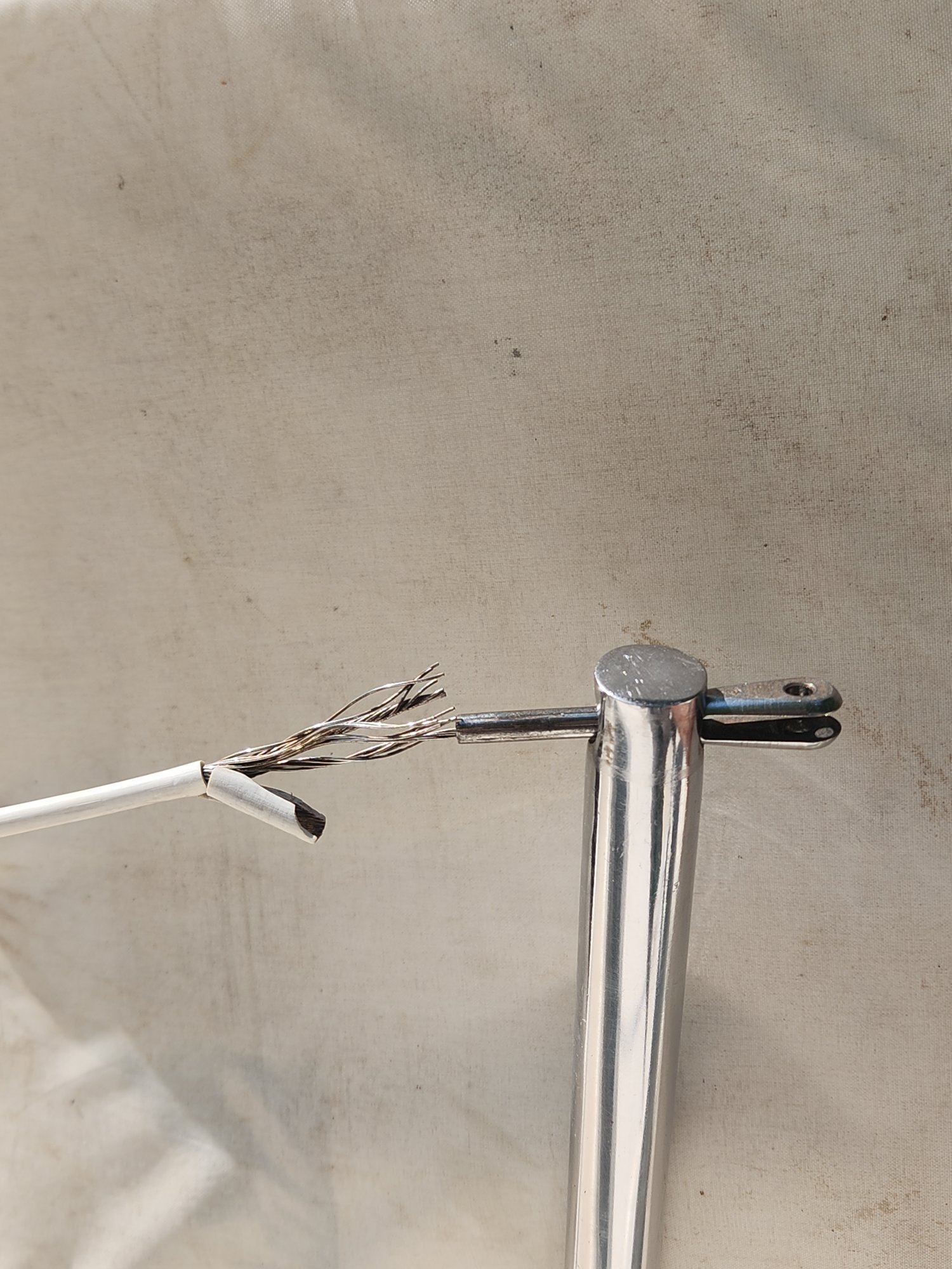

So I seem to have original coated lifelines on my 1980 Catalina 22.
They seem to be included enough shape for my upcoming season except this one location (see photos).
Do any of you have resources for repairing a line like this? I see stern line replacements available for sale online, but other than that just entire replacement kits which I don't need at this point.
Thanks!!!

This looks like the piece I need unless I can reuse the one I have with new lifeline wire.
LOOS Wire Rope Clevis Fitting: 1/8 in Compatible Rope Dia, Stainless Steel, Fork End
Yes, that looks roughly like the right part. No, you won’t be able to reuse the existing one, because when it’s installed it gets permanently compressed around the wire. The bigger problem you’ll have is that to install an end like that you’ll need to cut all the bad/untwisted wire off, and then use a specialty swage tool to fasten the new end on. My guess is once you cut off the bad wire section you won’t have enough wire left to span the length of the boat. Even if you did, I probably wouldn’t trust the rest of that wire seeing how the end failed.
Dyneema is not a bad option. It’s definitely easier to DIY. Just be careful that there are no hard chafe spots like in the stanchions. If there are you’ll need to add thimbles to make sure the dyneema doesn’t get cut.

Take to your local rigging shop or take it to West Marine and tell them to make you a new one, they will send it to their nearest store with rigging services.

Yes, that looks roughly like the right part. No, you won’t be able to reuse the existing one, because when it’s installed it get permanently compressed around the wire. The bigger problem you’ll have is that to install an end like that you’ll need to cut all the bad/untwisted wire off, and then use a specialty swage tool to fasten the new end on. My guess is once you cut off the bad wire section you won’t have enough wire left to span the length of the boat. Even if you did, I probably wouldn’t trust the rest of that wire seeing how the end failed.

I like the dyneema idea but every example Or online looks very ad-hoc / messy. Maybe there is a middle ground combining dyneema and turnbuckles.

For Dynema, you could always do a whoopie sling to make the adjustments, then sew it where you like the final size and cut the tail, would look cleaner, or have the whoopie at the bow end and just tie off the tail to make it look nice to keep the adjustability.
Keep in mind that being adjustable would be better in the long run, would give you room to cut an end if needed!

One end should be very easy to make neat and clean with a splice. For the other end either do the sling like Fred mentioned, or you could get a fitting like Tubular Turnbuckle with Splice end - LS-2900. (That’s just one example; there are quite a few types)

Take the life lines off, label them and send them to a rigger who can reproduce them in short order. A swaged stud will run about $15 and $15 to swage it onto the wire. ¼" 7x7 wire will run under $3 a foot.

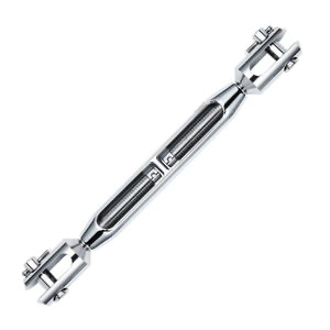

Turnbuckles come in several flavors. A closed body turnbuckle only lets you see the thread of exposed part of the toggle bolt. An open body turnbuckle lets you see the treads of the of the toggle bolt on both sides of the female so you can easily check for corrosion:

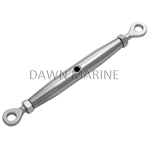

Closed body turnbuckles can trap moisture which is not good for the SS stud.
Closed Body Turnbuckle:
Open body turnbuckle:
