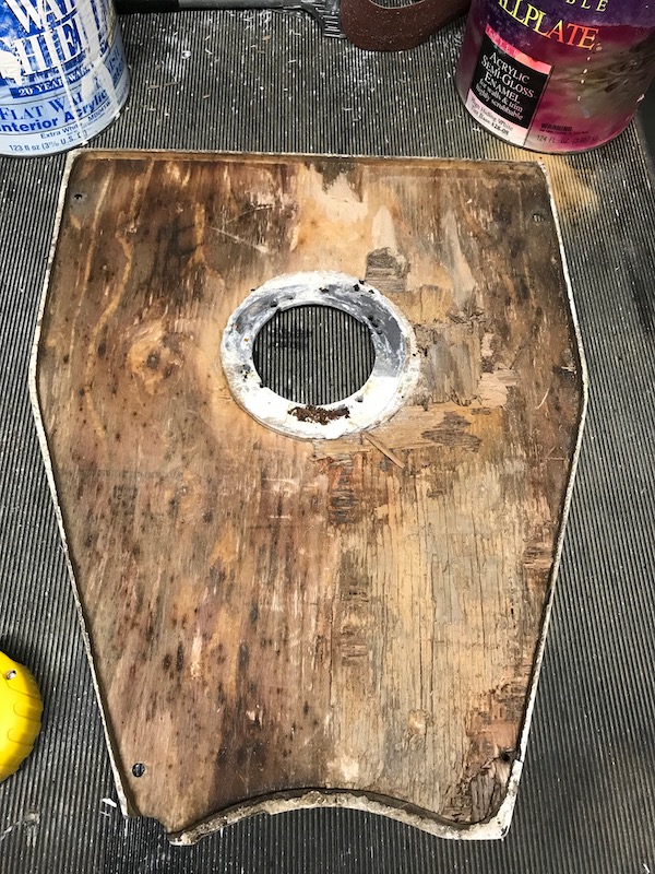

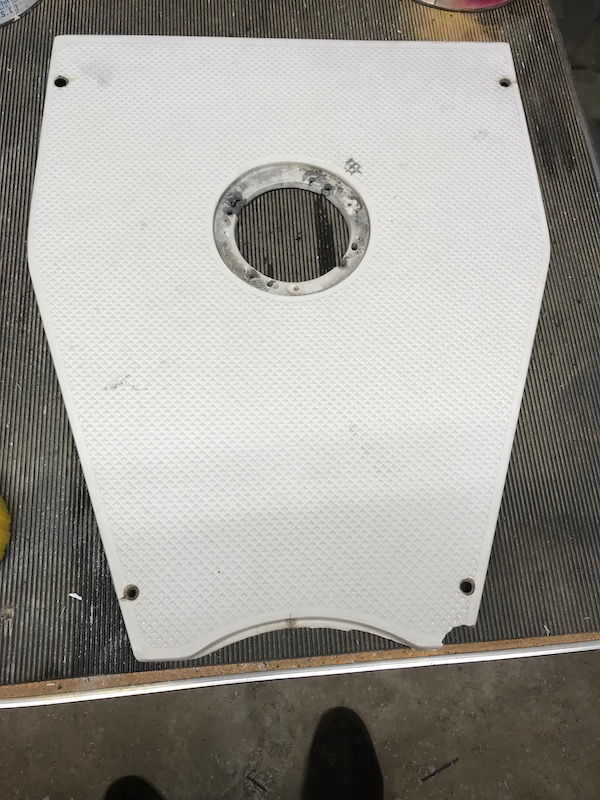

I'm ready to repair the quadrant cover on my C30. The core of 1/4" plywood is rotten and the cover sags when you stand on it when at the helm.
The bottom of the cover is just a skim coat of fiberglass and gelcoat. I'm guessing the strength comes from the top coat of fiberglass and plywood.
My question is what do I replace the plywood with:
1. Plywood. I have non marine but would I need marine grade?
2. Balsa, which I have
3. G-10, which I have
I was thinking that the G-10 epoxied to the top layer of fiberglass would be the strongest and not I would not need replace the bottom skin. Weight isn't an issue.
Here are a couple of photos of the 16" x 20" cover.

It seems like a pretty large area for 1/4 inch plywood. does it have center supports?
No center supports or stiffening ridges. One of the reasons I was considering G-10 over plywood and balsa was I thought it would be stiffer.

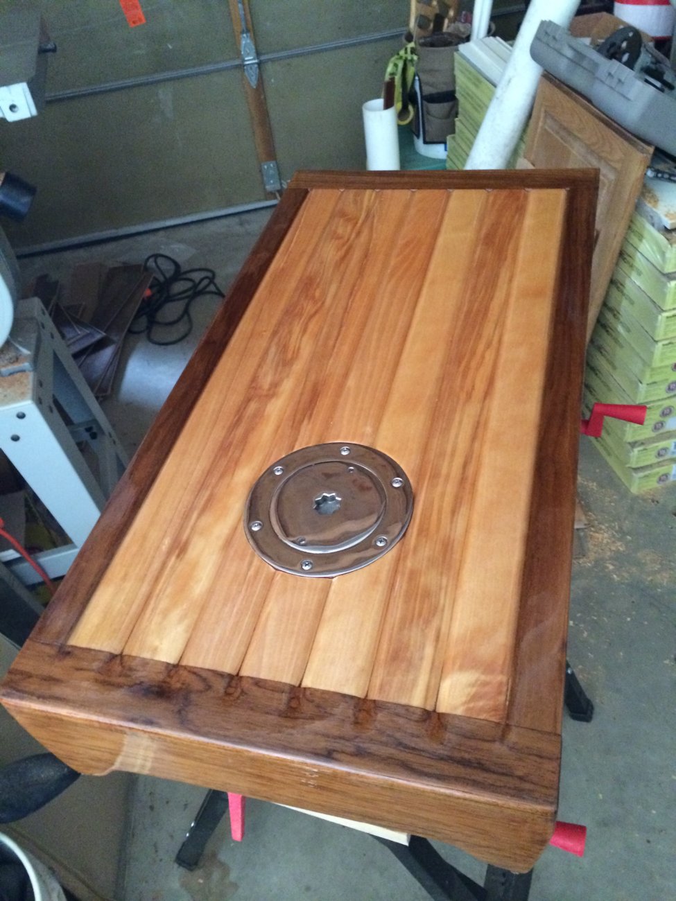

So my H28 had a similar problem. I built a new custom cover made from teak and birch paneling with a stainless cover for the emergency tiller access.
I'm an amateur wood worker so, things I learned, even though the entire cover (all sides) was covered with epoxy, I should have allowed more room for expansion and the back needed more support where it hung over the transom. However, overall it came out nicely and was much sturdier than the original and certainly nice to look at.
Just an idea :)
