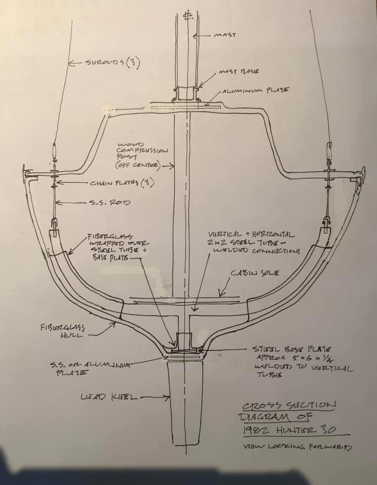

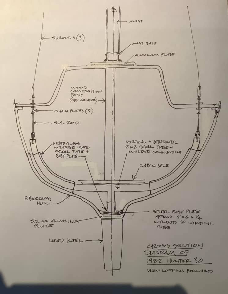

On a 1983 Hunter 30 - Can anyone please tell me what potential costs I am looking at to have this issue repaired?
"the horizontal rib is bad, that’s a bigger deal, hard to replace without major surgery", (I've attached a diagram drawing).
In other words, the bilge mast step & chain plate is completely corroded out, extending through the port & starboard side, and corroded at least through the port side .
