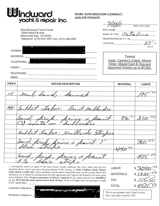

Wow... Yes.. that is more than I paid for my boatJon_E said:The prices vary by the existing condition of your hull and, of course, who is doing the painting. Here is one quote I received a little less than a year ago for my Catalina 27.
It was more money than I wanted to spend at the time so I did not go forward with it.
