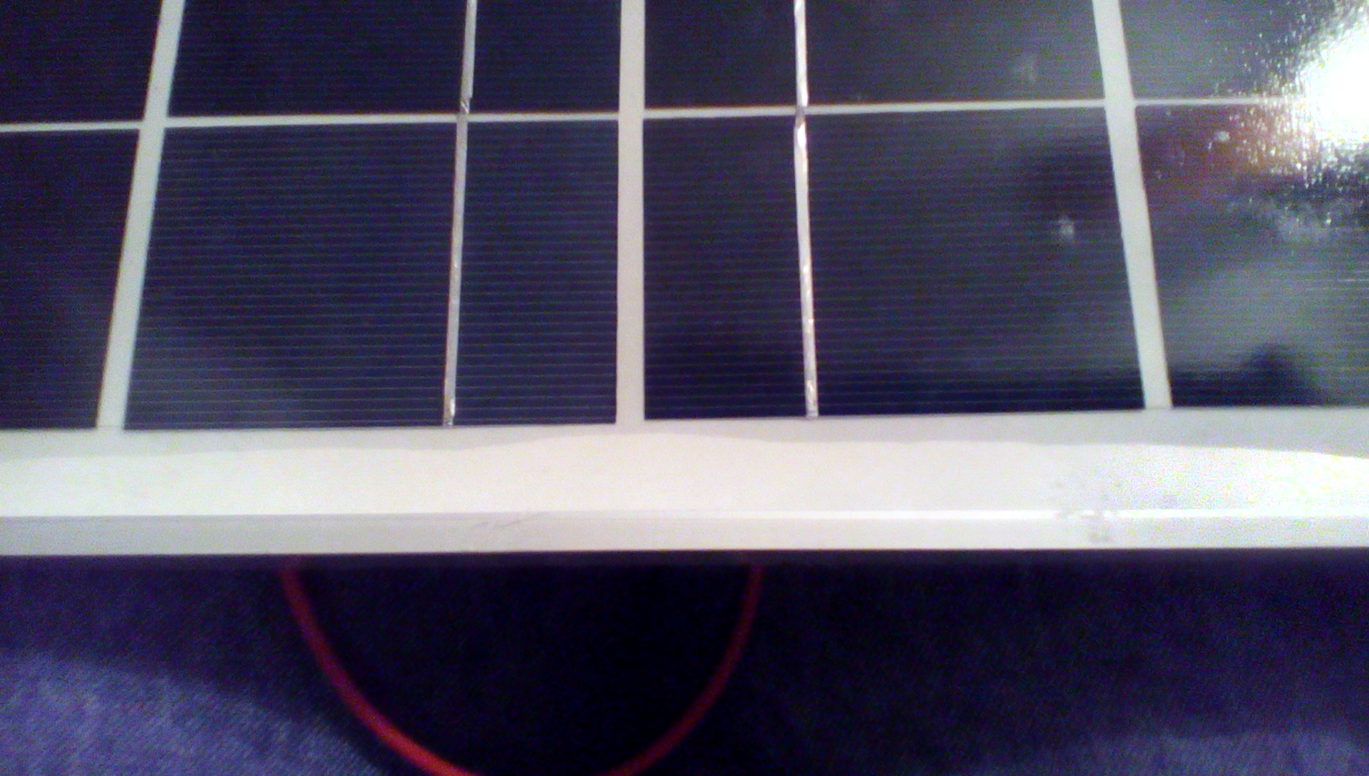

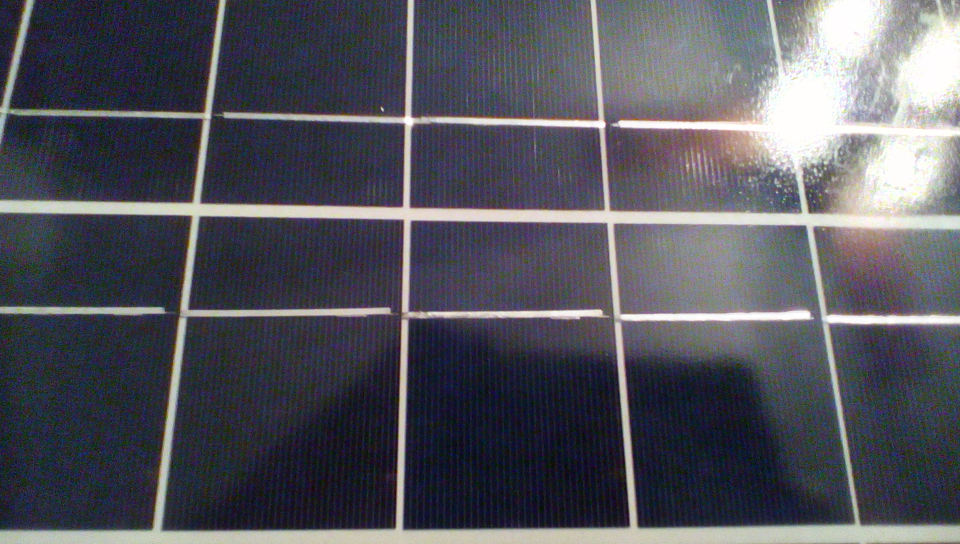

This is my first attempt at solar. I purchased a 25 W panel from Renogy and am a little disappointed in what I perceive as 'quality'.
Several of the lines appear to not be same diameter and there appears to be some issues around the perimeter of the mounting board(worse on one end than other perimeters).
Should I worry about these things (remember, first experience with solar panels). Just purchased/received, not installed. If a problem, would like to get it corrected before any other expense incurred.
