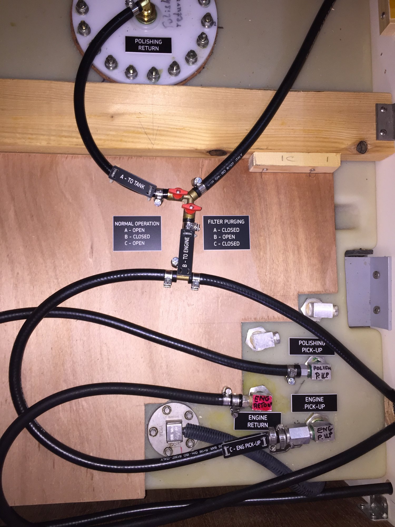

I would be very surprised if it is not secured. In attached photo you will see how the 130 liter fuel is secured to the boat structure. I think Hunter has certainly attached the much heavier water tank in a similar way.
One big hold down timber and 4 grey L metal hold downs.
