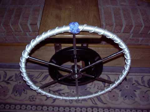

You want something like this?
Rich, Exactly, cloth on the nut with a big cresent wench will work fine. Just make sure you don't drop the key. St Mary's hitch is fine. In this picture I used a rolling half hitch which gives the spiraled look. I'm at work now and when I get home I send you the directions for this. Jim S/V Java

Rich, I'm still looking
Well I've just about torn my office apart looking for the instructions for the brading on the wheel. I'll let you know when I find it. Try attached link for a look at my wheel. Jim

Rich and anyone else. look at this site: http://www.northnet.org/ropeworks/archive/ringbolt.html This is the ringbolt but I modified it by continuing to half hitch only in one direction. The important parts of starting and stopping this process is in 1,2,3 and 8,9,10,11. It makes for a very clean appearance. I also started at the top and went half way then went back and started in the other direction. I used a different way to make the turks head knot but achieves the same look. I used a double braid, and sewed across the braid, cut it, then wrapped around the wheel and sewed the ends to complete the wrap. The type of line I used was 3/16" (#6) solid braid nylon. This can be purchased in two 50ft rolls and used about 180ft of line for the H260 wheel. Jim S/V Java
