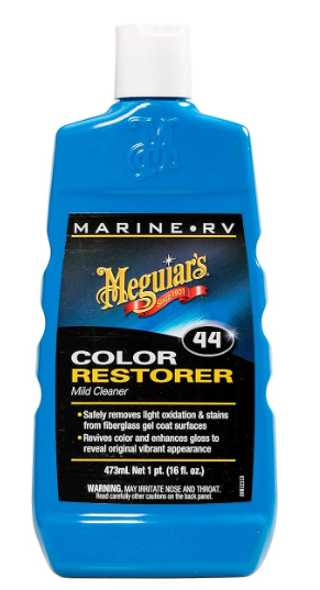

Something that has always removed every stain you can collect is :
It is an extremely light abrasive which will remove gelcoat oxidation but not gel coat. Even the cheapest gut rot wine a guest brought aboard and then proceeded to spill it wherever he could. Water and soap couldn't touch this stain on gel coat but Meguiar's #44 and some elbow grease did the job. The fabrics, not so good.
