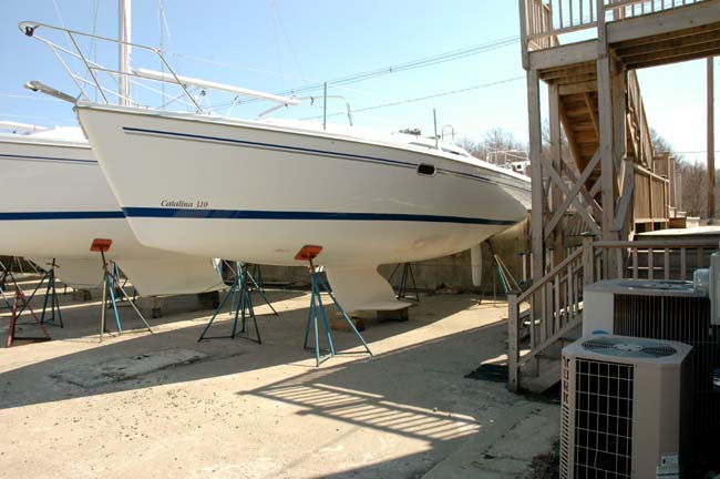

My wife & I scraped off the 1" stripe on our topsides with razor blades and basically competed to see whose side could get done first. That wasn't very smart. I'll have to admit to doing more damage to the gel coat than she did ... and I wouldn't recommend thinking that the repairs won't be all that troublesome. They were, and they don't look good. We found that the stripes came off better in direct sunlight and not very well in the shade (it was a cool spring day). I recommend using heat, like Tim says, and being very careful with the scraping tool of your choice.

I applied new (tape) stripes while laying on the dock with the boat in the water. It came out looking a little wavy which I notice pretty readily. Oh well, it looks like I will have another attempt at this project!

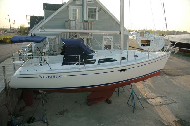

On our 2005 Catalina I spent nearly two and a half hours with heat and finger nail removing just 6 feet of the silver cove stripe. It was the type that would not peel and would fracture and come of in chips instead. I then hit the local autobody supply shop and picked up a 3M wheel. In just 20 minutes the the remaining 25 feet of stripe was gone. The most recent boat I did was a 1996 Mako and though the stripe was nearly 3" wide it came off just as easily and quickly.
Before - Two cove stripes:
After - One cove stripe:
The 3M wheel saved me a lot of time...
