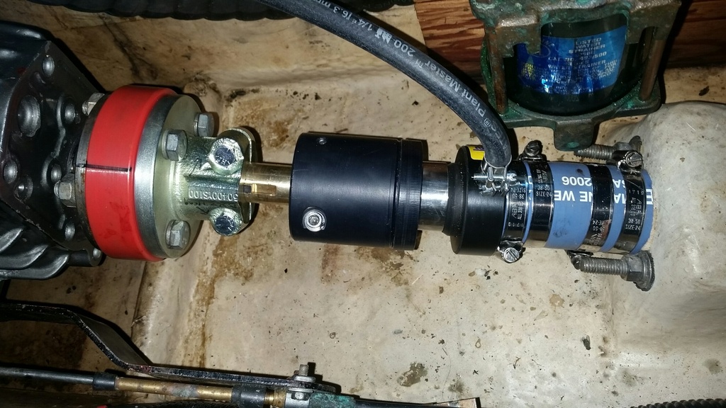

In preparation for installing a PSS dripless packing and replacing the cutless bearing while I am at it, I purchased a split coupling, this will allow me to split/cut the shaft coupling and replace it with a new coupling so I won't have to deal with the difficulties reinstalling or separating the coupling in the future.
Same here. Except I went with a LasDrop GenII shaft seal. So far so good.

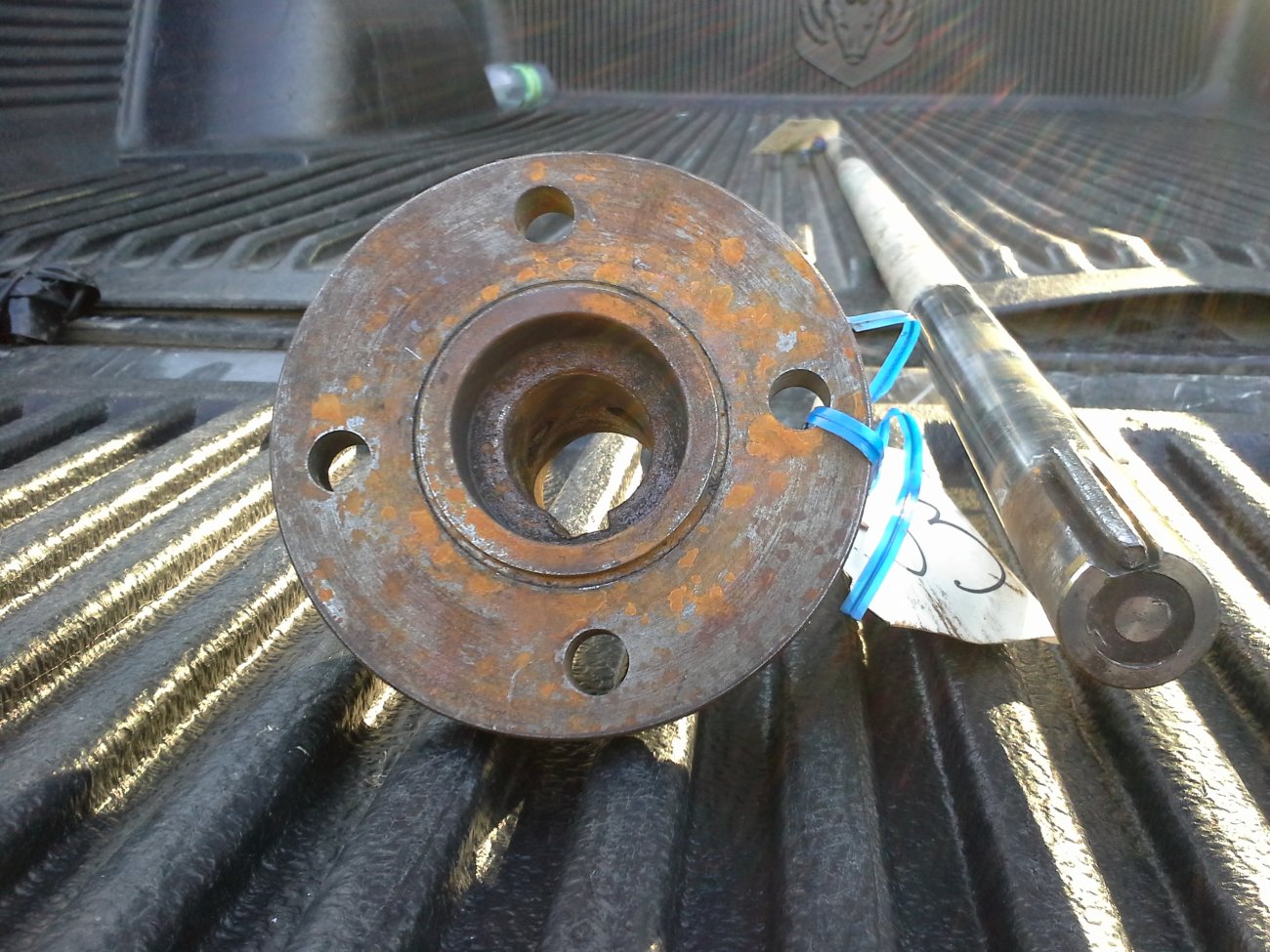

Here's what can happen when you just go ahead and reuse one. The previous owner of our Seaward 25 replaced the PSS seal on the boat and reused the coupling. This is what the shaft and coupling looked like when it failed on me. Had to replace shaft, coupling, and why not...did the PSS all over again with the newer vented version, and replaced the cutlass bearing while I was at it.
