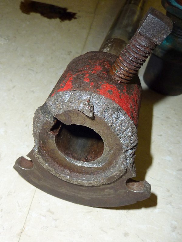

Doesn't take Godzilla when that flange is aligned to 0.003"... Please be very careful using this technique. Oh and don't bother with the acetone ATF mix BTDT and does not work nearly as well on non-scientifically rusted parts as that article makes it sound. PB Blaster and keep it away from the transmission output seal!!!
This boater was very lucky he broke the shaft flange and not the gear box flange. Despite his gear box flange not physically breaking, it was now severely out of true. The only way to fix the bent gear flange was to do a gear box tear down & rebuild.
Despite the gear box output flange not breaking, it still cost $1750.00 to fix the bent gear box output flange. Remember these flanges are going to be aligned to 0.003″. It does not take a lot of force to bend the output flange by 0.003″.
If the coupling does not come off fairly easily you can cut the coupling just over the key way as seen in the photo above. Creating the cut, at the keyway, will ensure that you don’t damage the shaft. Once cut it will relieve the pressure and the coupling will then come off.
IMPORTANT: Cutting a coupling this way takes tremendous patience and will cover the interior of your vessel with iron/steel dust. Once moist/humid air sets in it will turn everything it landed on into a rusty looking mess. The better option is to simply cut the non-ferrous brass or stainless shaft.
If you can’t get an angle grinder in there to cut the coupling you will likely need to cut the shaft. Not all couplings will come off so PLEASE don’t ruin your transmission in the process.

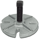

Algonquin shaft puller. Cost about $40. I bought one but have not had to use it yet. Looks promising to me.
