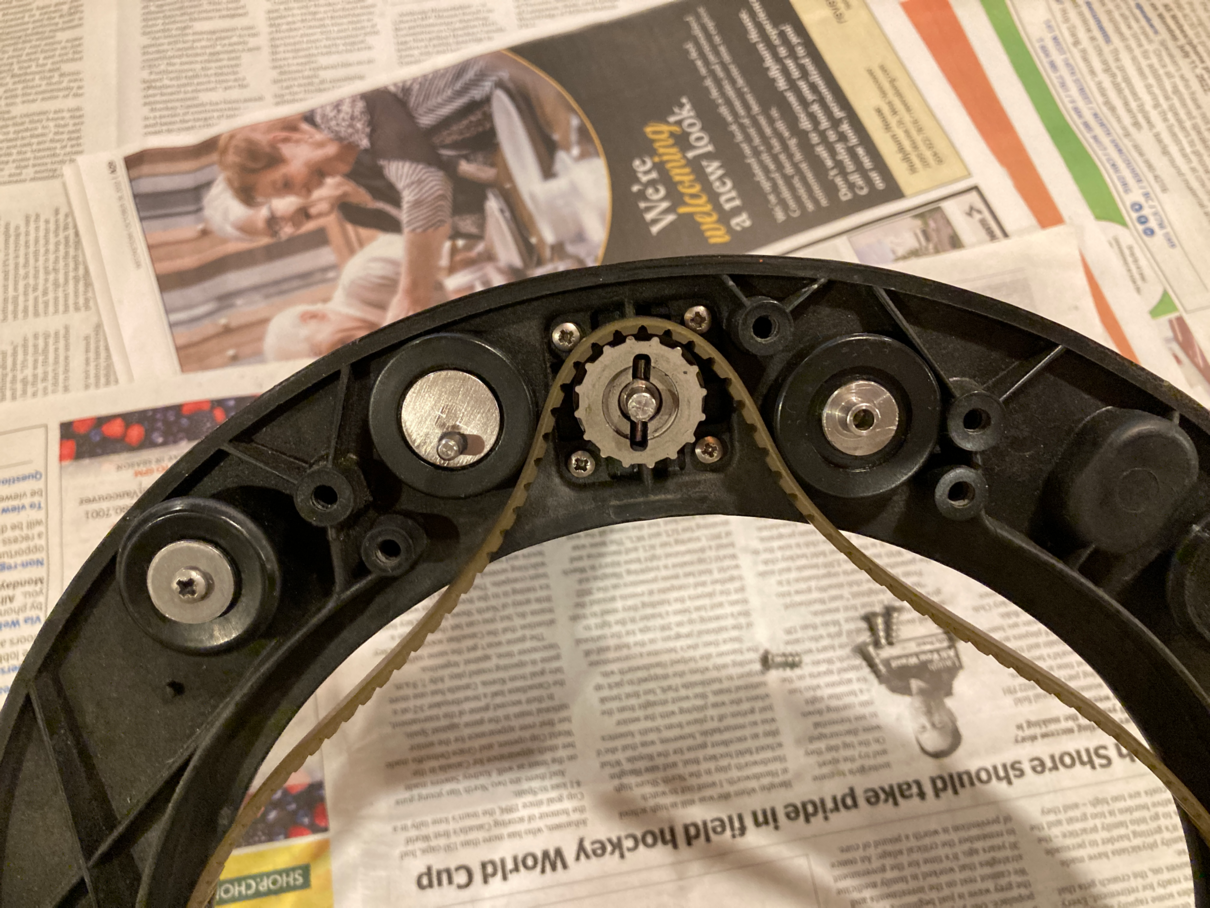

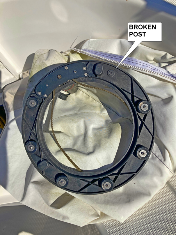

Clean up the parts of the AP and get a new belt, and you should be good. Inspection for cracks at the stud holes ( someone posted a fix on this thread).
If the little motor works, and the ring is in good shape, a new belt should give you a working AP. Way cheaper than buying a new one.
I rebuilt my old ST4000 before upgrading to the ST6001…
