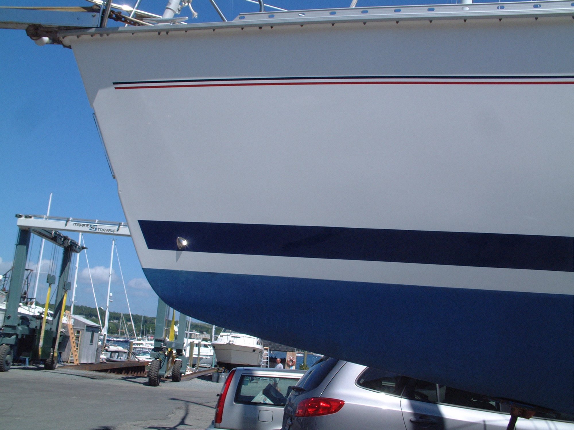

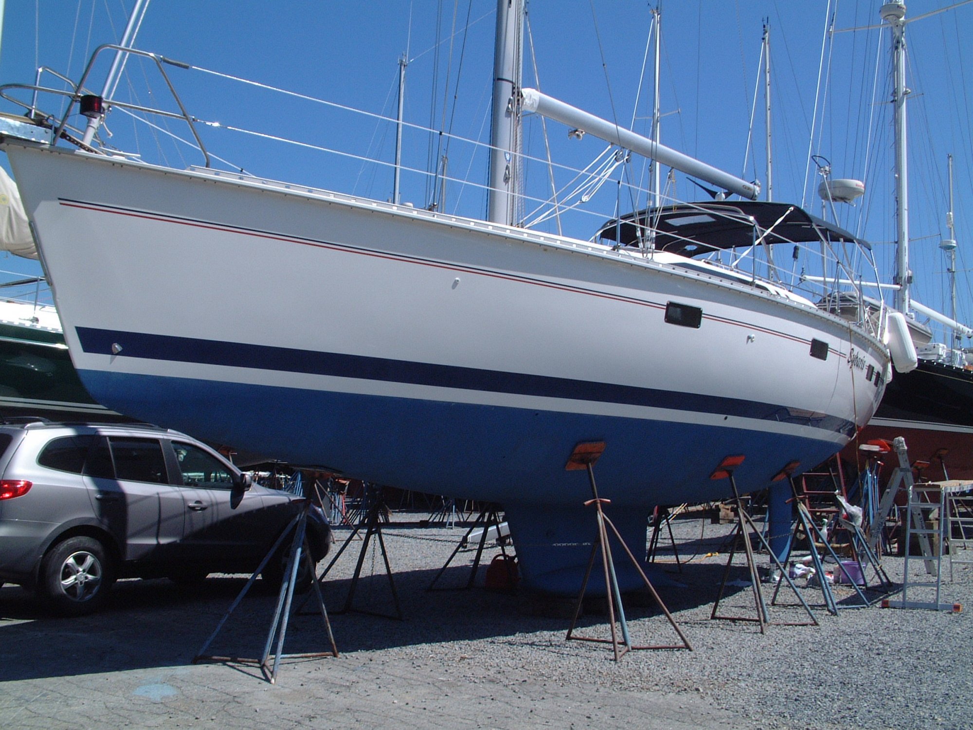

The blue boot=stripe on my Hunter had become oxidized badly over the years and I was unhappy every time I looked at it. General compounding and polishing just wasn't cutting it.

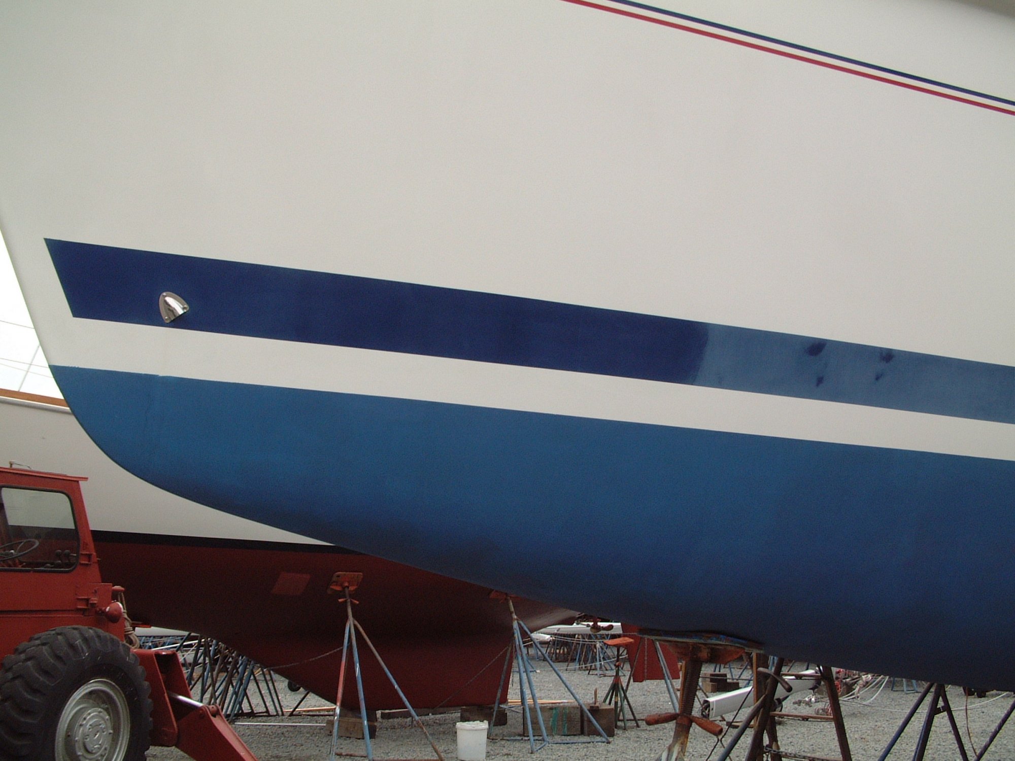

In the pictures below, you can see the results I obtained. In this first picture the badly oxidized boot-stripe can be seen on the right hand side. On the left side I had polished with 3M Marine Compound and a buffer with a heavy cut wool bonnet. In this area it was better but not great.

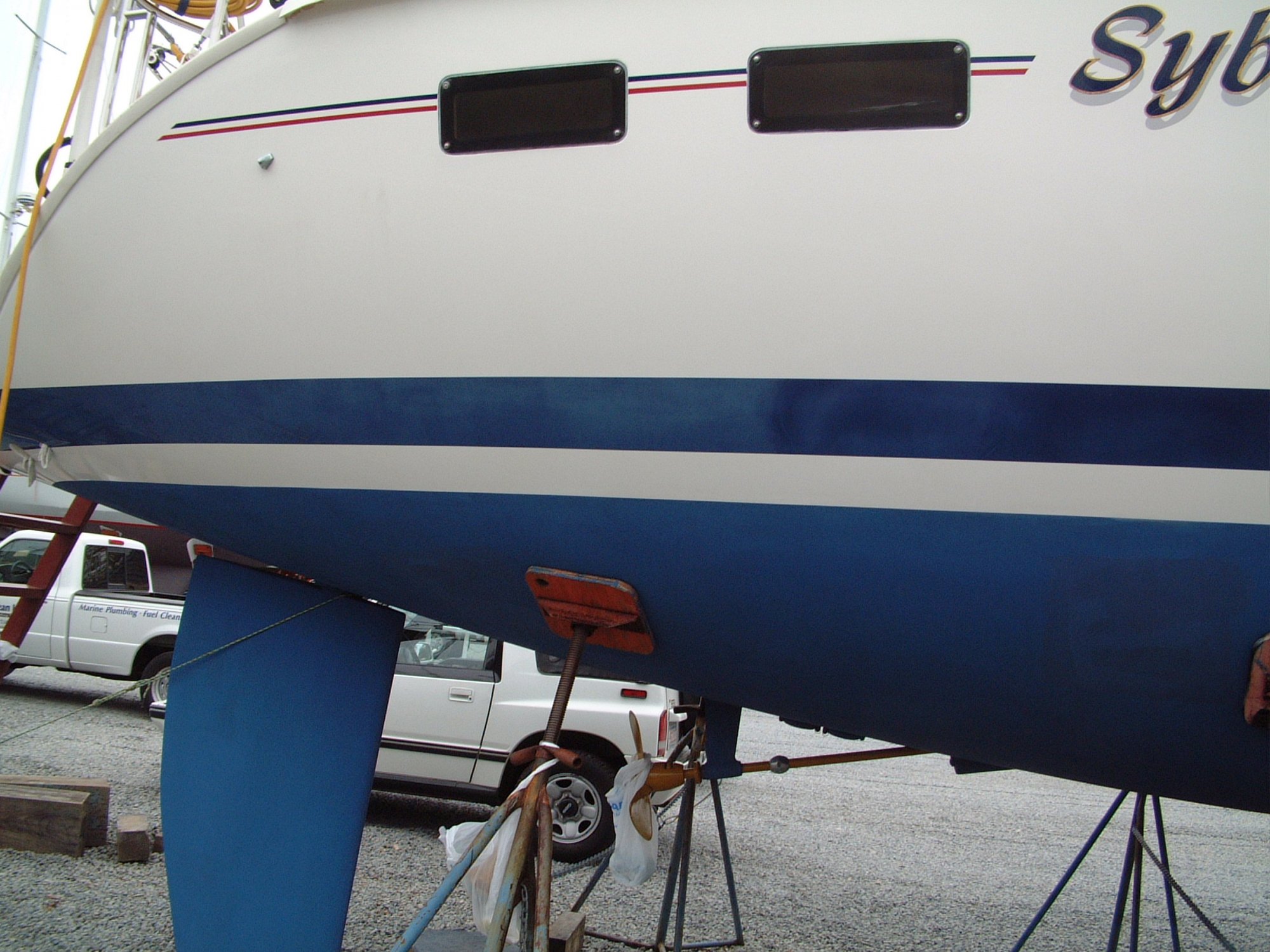

In this picture I had polished a different area with the 3M Marine Compound but the results were still poor.

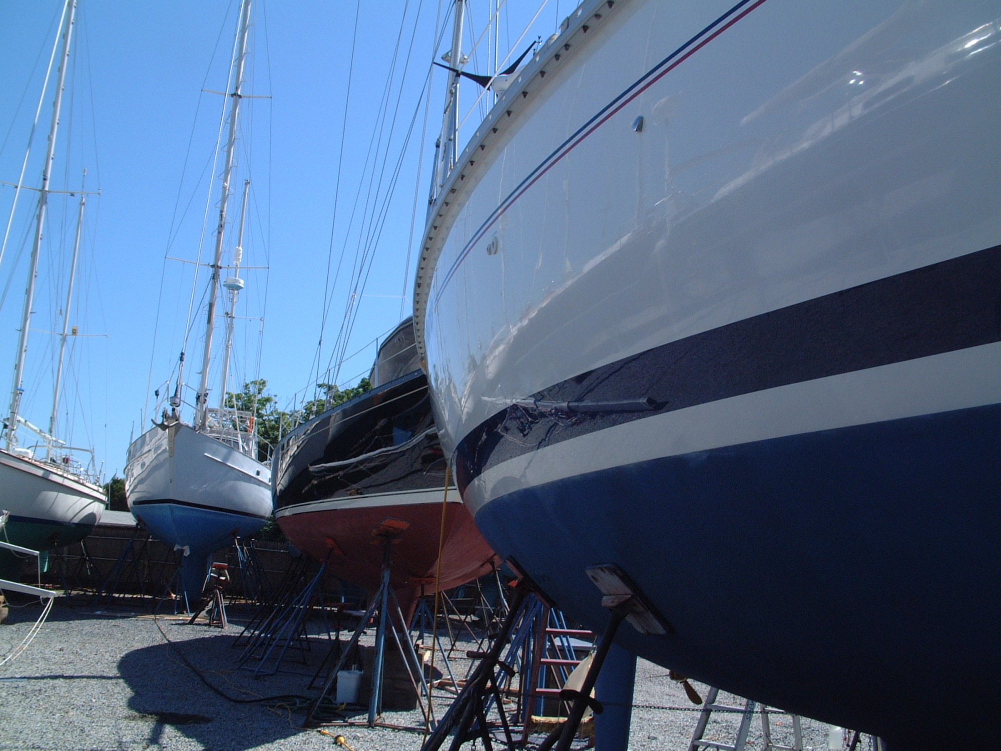

So I bit the bullet and began wet sanding. I spent the whole day on the boot-stripe. I sanded with 600, 1000, and 1200 grit wet paper with a soft foam block by hand. Afterward I used a different polish- Presta Super Cut - with my same buffer. The results as shown below were dramatically better. The real improvement was due to the wet sanding. And IMHO I think that the Presta products perform better than the 3M products - and less expensive too.
The bottom line for me is that if you want to really restore the oxidized areas to like-new, wet sanding is the way to go.
