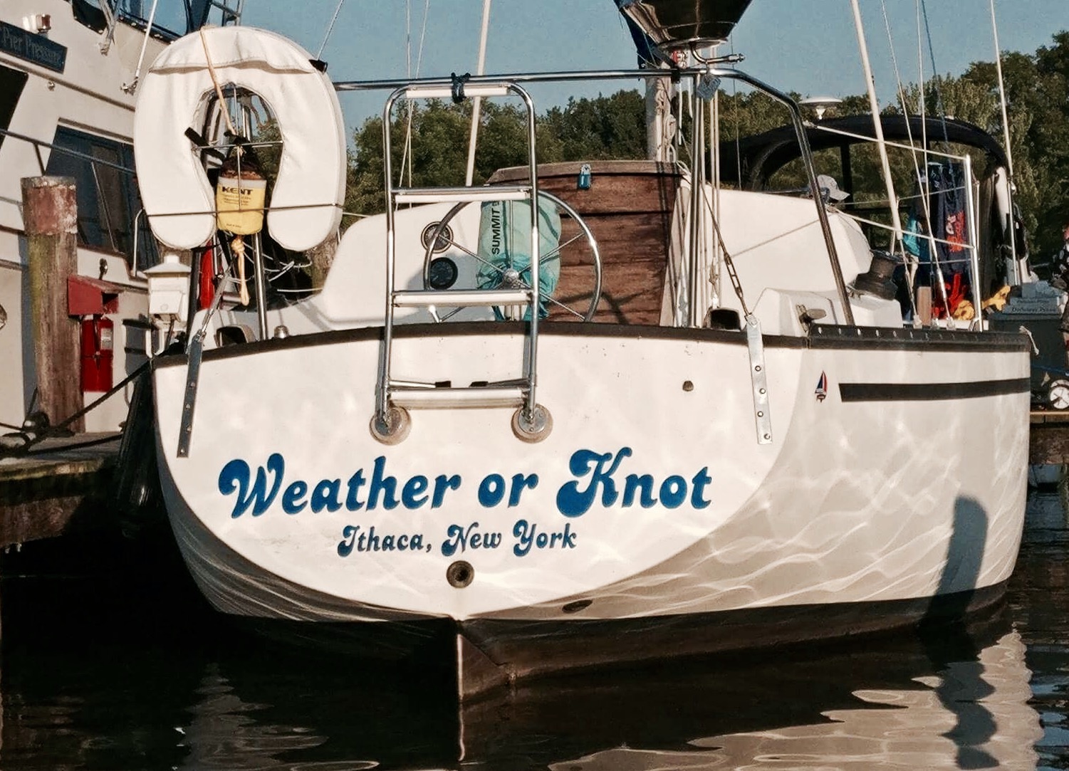

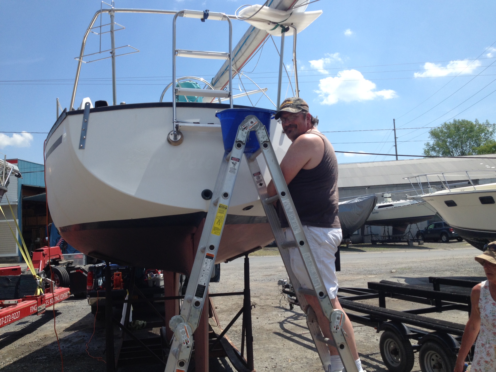

If you’re careful and patient, a single edged razor blade in supporting handle works awesome, without a hair dryer or heat gun. You know, like the kind used to scrape an inspection sticker off your windshield. This is how I got my graphics off, and this is my bro-in-law prepping the transom for the new graphics. No gouges, no scratches. Just old brown vinyl lettering came off. We prepped with 1200 grit wet sanding to remove the UV damage, and an Isopropyl Alcohol final wash before new graphics.
...and this is with the new name (graphics) applied.
