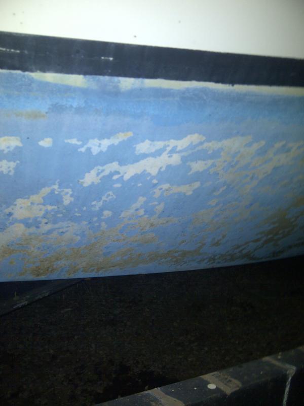

What is the best way to remove several layers of old bottom paint?
What is the most economical way to do this?
This is a task that I will inevitably have to do with my boat. It has several old layers of ablative paint on it. I would like to take it down to gel coat next winter. I am considering paying someone to soda blast it but that is expensive.
