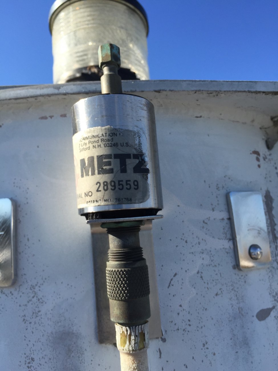

My ‘81 H36 has a Kenyon 5280 CR mast. The axle pins have integral stainless steel plates on one end (see left and right side of the photo below looking at the of the top of the mast). The plates are held in place with single machine screws. I haven’t tried removing these at the top of the mast yet (concerned about dropping things from aloft) but have at the base. The pins (at the base) pull out easily with the plate.
