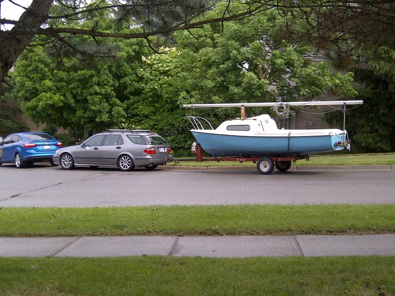

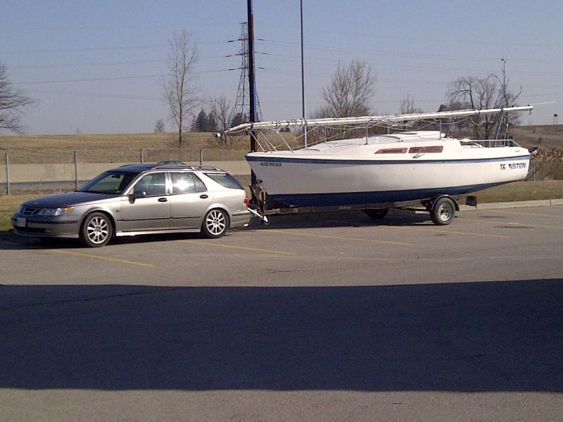

Here are pictures of my Siren 17 and my Mac 26D ready to travel.
I have since changed the front mast support on the Siren to the last picture. Now there is no post at the foot plate. Just a front and rear support.
