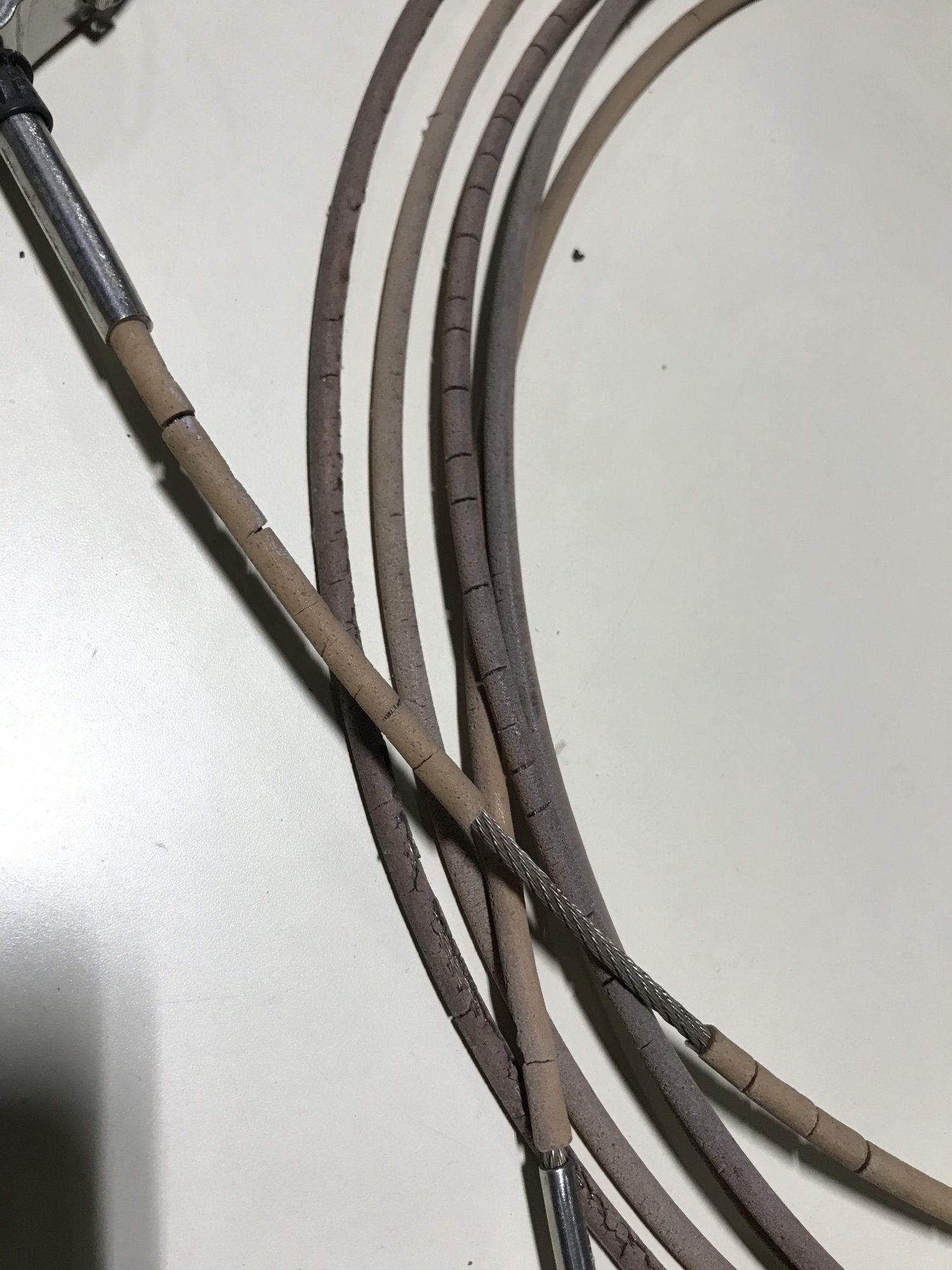

Has anyone removed the coating/cover material from a lifeline? It’s looking pretty tired but I can’t think of a convenient way to remove it. Don’t want to damage the cable that it seems to be adhered to. Would like to replace it with a new removable cover of some kind or just leave them bare. Its from a 1993 H23.5. Any advice is appreciated.

Try making cuts lengthways and peeling them with pliers.
Do a thorough inspection after you get them uncovered. The issue with vinyl coated wire on a boat is the hidden corrosion from trapped water under the vinyl.

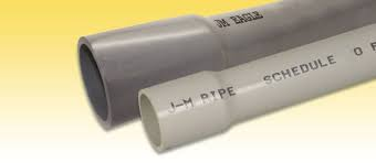

That is a good idea! But sounds like a lot of work. You got me wondering if that grey tubing used for electrical conduit wouldn't make a nice cover for the lifelines. It comes in several colors and it is cheap. ????????? I'm also now thinking I might get some of the blue pipe and replace the chafe covers I have on my shrouds. I currently have white PVC pipe and the blue would match my sail covers, bimi etc.

I removed mine that were in the same condition as yours, to comply with race requirementms and found that the wire underneath was great. I removed them from the boat and lashed the end clevis to a strong post and used an old paring knife like a two-handed draw knife. hold the blade at a slight angle and pull it along the wire. It shaved off one edge and the rest pealed off. The wire underneath had some red staining but I was able to remove it with a quick application of Wichinox and now they sparkle like new. I was sure PO'd to find out that Wichard discontinued that stuff cause it works great. Fortunately, I still have 1 1/2 tubes on hand. :kick:

Back on topic, if you can find Wichinox, it worked great to clean and passivate my old ugly lifelines with a simple wipe on, wait, hose off. The wire under the cover had no pitting or broken wires and just a bit of surface rust staining.
