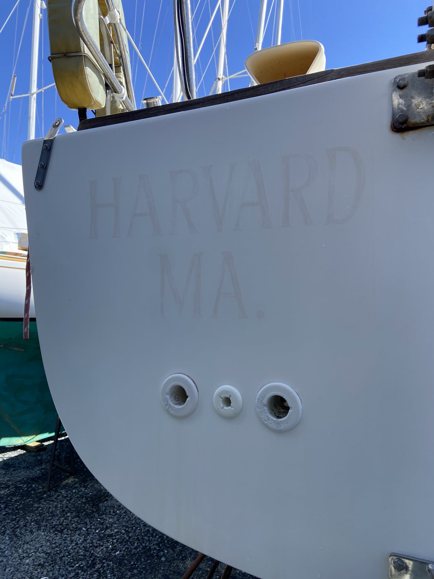

I recently wet sanded off hand painted lettering on my transom, but the paint discolored the gel coat leaving it slightly yellow. It’s also slightly raised where the letters were. What’s the best solution to get rid of the color? I don’t mind that it’s raised a bit.

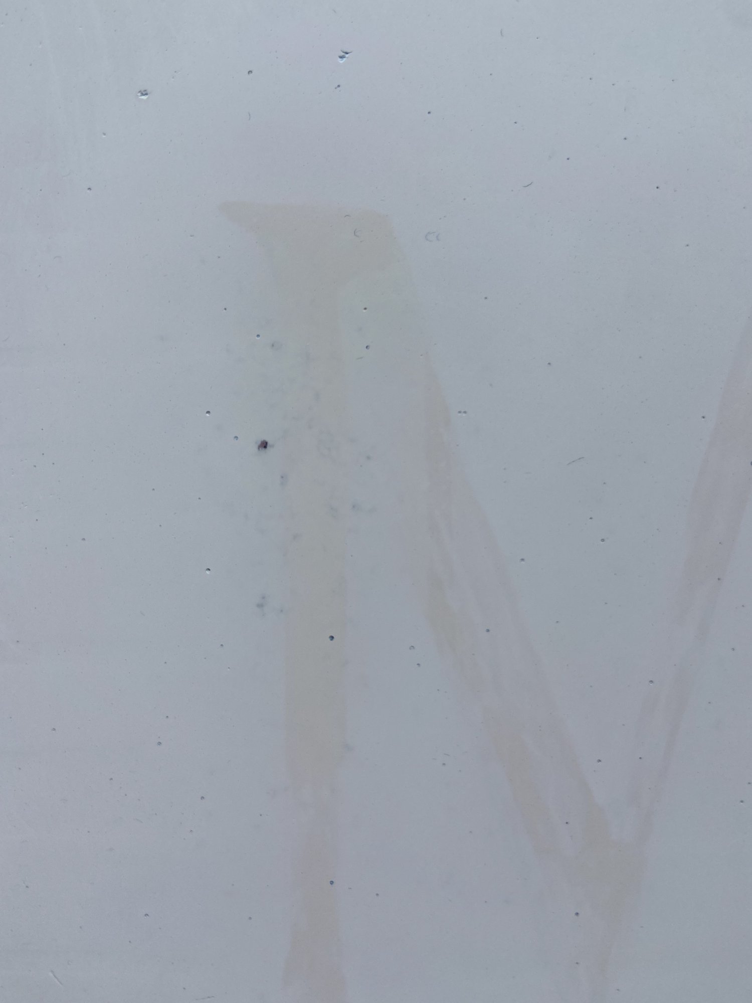

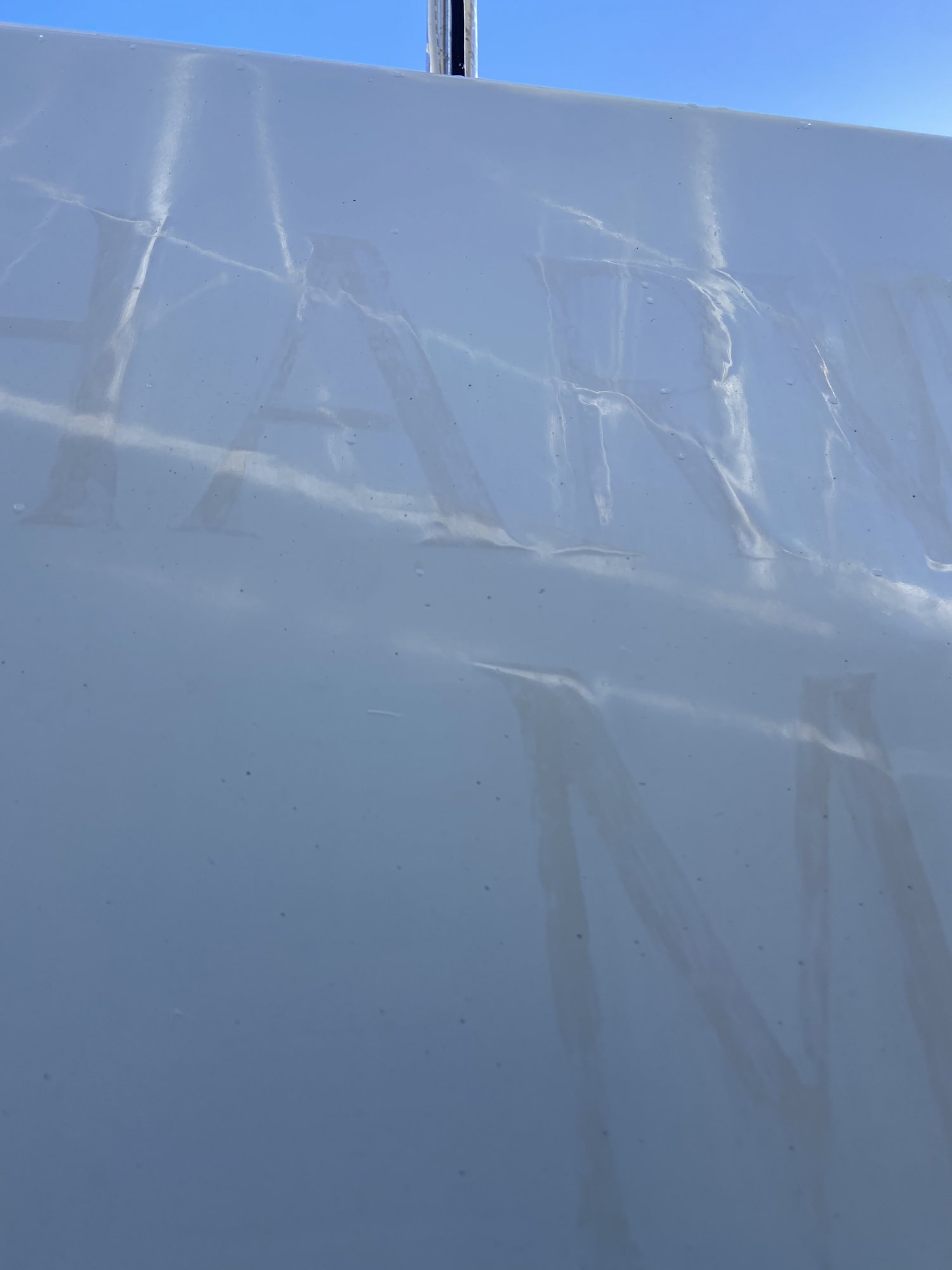

I tried FSR and on off, both didn't work. I then tried wet sanding but I started to burn through the gel coat, see the photo. Looks like the stain is almost all the way through the gel coat. I think the only option is to cover it up with paint. I'm not willing to paint it, so I guess we will see if it fades after a few seasons. Thanks for all the input.

I thought it looked like the gelcoat has been bleached out except where the letters were rather than a stain.
Oct 18, 2021
14
J-Boat J/30 Provincetown
I think that’s right. Yesterday I took off an old compass, underneath the gelcoat had a yellowish tint, very similar to the color under the lettering. So I think most of the boat has been bleached out, but anything covered has retained it’s yellow tint. It’s interesting that the bleaching is almost all the way through the gel coat, I would have expected the wet sanding to reveal some yellow tint directly outside of the lettering.
