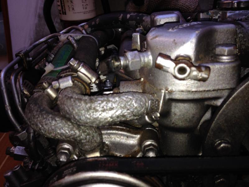

The heater is "run" from hose extensions that begin from underneath the thermostat housing and above the coolant circulating pump on the front of the engine.
Then the hoses run to the heater connections.
Your BEST BET is to disconnect the hoses at the engine end, rather than the heater end, primarily because the ones at the engine are a LOT closer together.
You'll need about 6 to 8 inche3s of 3/8" heater hose. Simply disconnect the two hoses from the engine (3/8" engine to 5/8" heater) and install the 3/8" bet6ween those two connections.

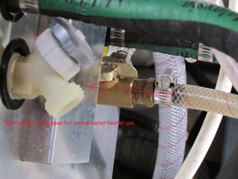

Not an exact picture
I can get one next time I am at my boat, but here is a picture of the kit. The Tee and the Check Valve (brass thing in the middle) go on the outlet on the left side. The switch valve (brass thing on the bottom) goes on the inlet on the right and the hose connect the valve on the inlet to the Tee on the outlet which is after the check valve directly attached to the outlet fitting.
Thank you! Where can I get one of those? So that *after* I replace the water heater I can hook one of those up?

I honestly think plugs can work because from the literature it sounds like the engine can run with the outlets to the heater plugged up as the water heater is just an add on. But what do I know, so I think Im gonna just hook up a hose between the outlets on the engine and get rid of the nasty old hoses anyways.
Then after replacing Im gonna hook up the bypass kit as shown by Paulj and Rpwillia.

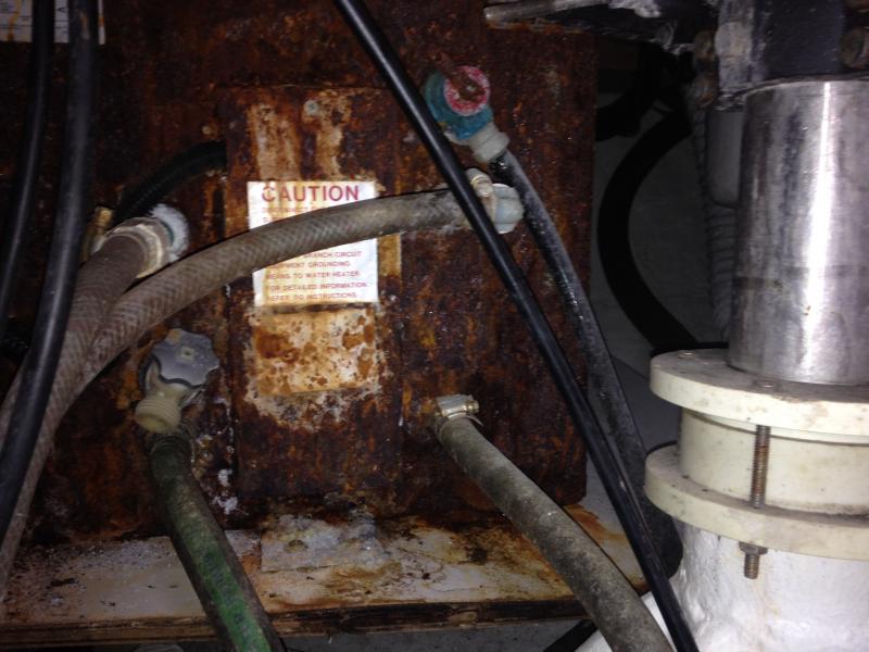

Here are some pictures of what Im working with. Now you can see why I want to bypass. The corrosion on the Water heater is a result of years and years of an unchecked leak from the transom shower plumbing.
I managed to fix the leak in about an hour and a half (Coulda been done in twenty minutes but I'm still new at this stuff). I just can't believe the PO (And the charter fleet it was in) Let such a small thing wreak so much havoc.

I got my Camco kit at an RV store for about $15-20 dollars. West Marine also has them (same part #) for about $38 as I recall. :snooty:

1. I honestly think plugs can work because from the literature it sounds like the engine can run with the outlets to the heater plugged up as the water heater is just an add on.
2. But what do I know, so I think Im gonna just hook up a hose between the outlets on the engine and get rid of the nasty old hoses anyways.
1. Noooooo. Don't plug them, use the hose or else your engine will overheat. Big time. The hose connections I mentioned are NECESSARY for the coolant pumped circuit to work at all. Please, read your engine manual.
2. Now you know, and why.

OMG looking at the photos I can see why your hot water heater might be leaking...:eek::eek::eek: I have never seen one in that condition..
