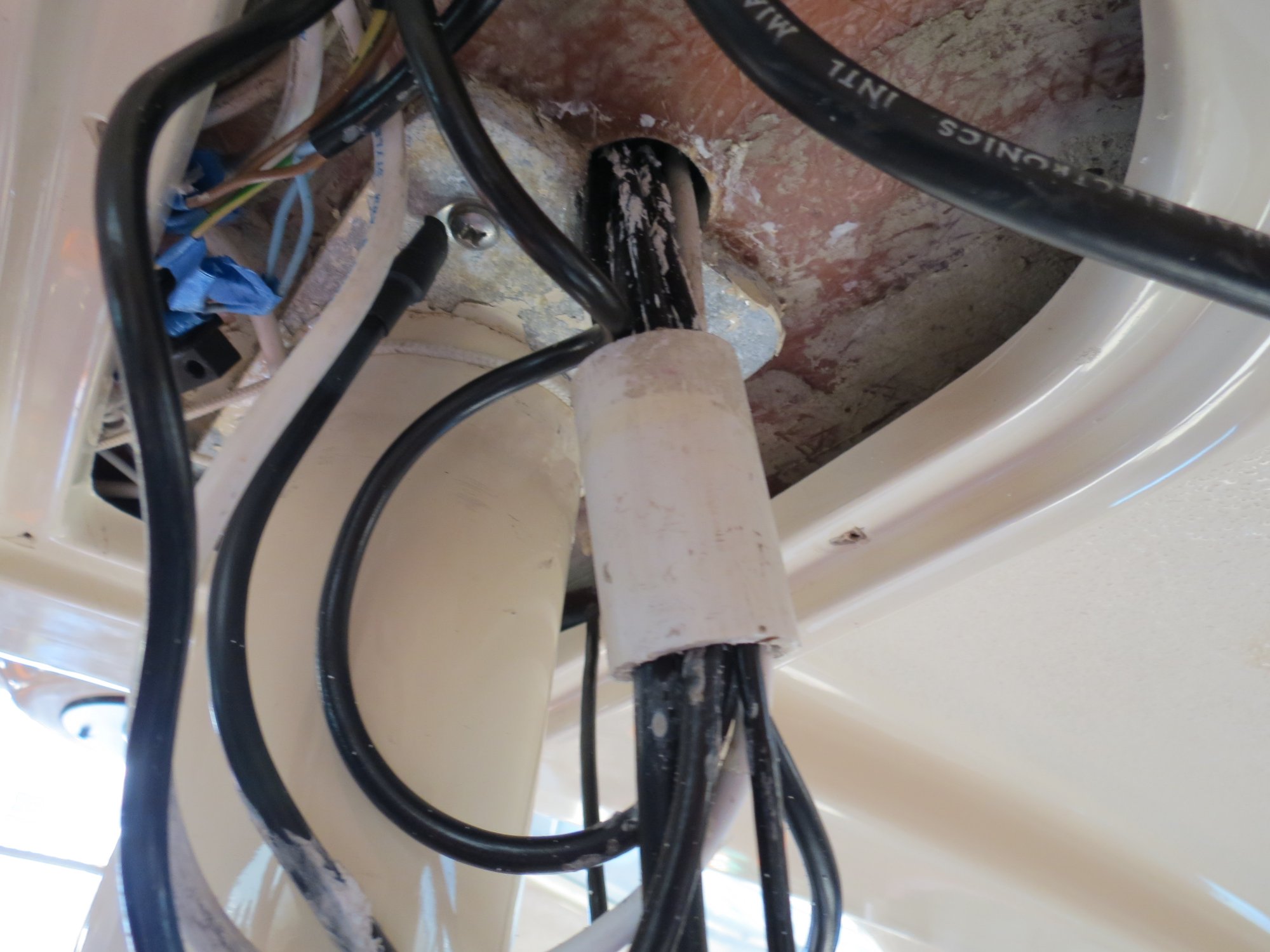

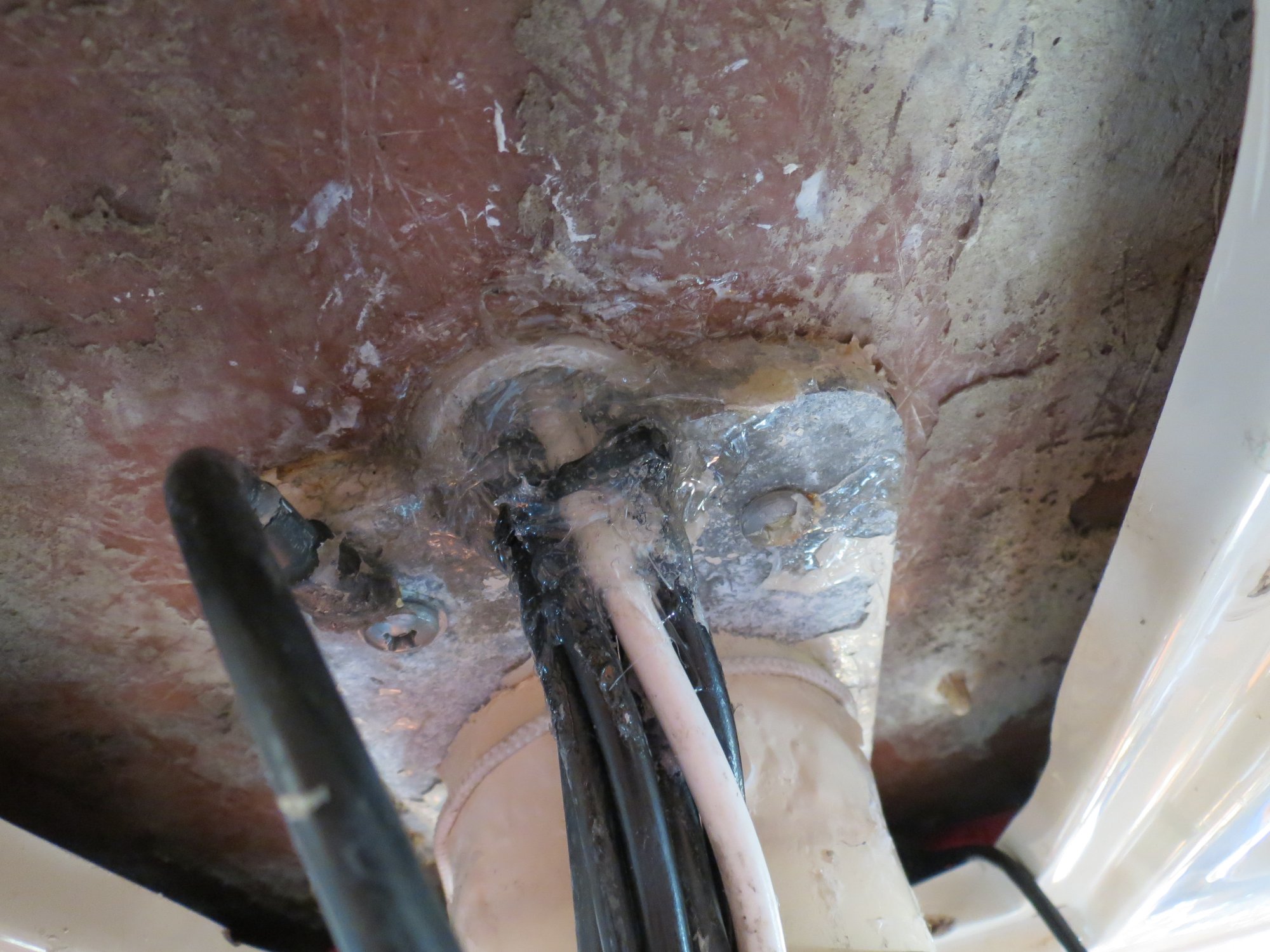

From my photo archives- The wire bundle passes through a short PVC tube. The top of the tube is about 1-1.5" above the base of the mast step and is about 0.5" below the fiberglass deck at the support inside the salon. I think the PVC tube is about 1.5" in diameter, but you should check that measurement if you are going to replace the tube with a longer one. I would replace with a tube that is 2-3" above the mast step. This PVC tube is caulked into the hole and the wire bundle is caulked into the tube itself.
The caulking on the wires inside the PVC tube is a problem because unless you take great effort to work the caulk between all of the wires, there will be air gaps inside the bundle that will let water run into the cabin between the wires.
Water intrusion can be eliminated by creating a loop in the wire bundle inside the mast before the bundle is inserted into the PVC tube. DON'T LEAVE THIS TASK TO THE YARD; CREATE THE LOOP YOURSELF SO THAT YOU KNOW IT IS DONE AND DONE CORRECTLY.

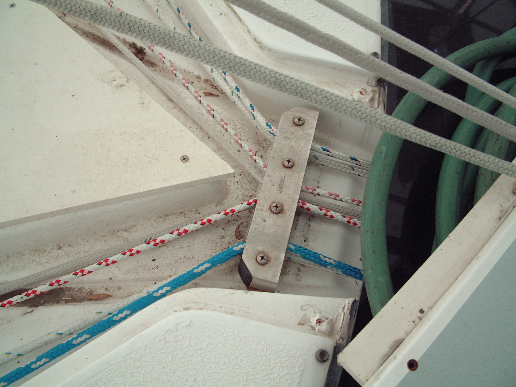

The other spot where water can get into the cabin top and leak from the cover plate around the mast is from the screws that secure the line organizer cover. Remove the cover and clean the area by the screws. Apply caulk to the screw holes and to the screws themselves and replace. The third picture below shows the two forward screw holes before cleaning.
