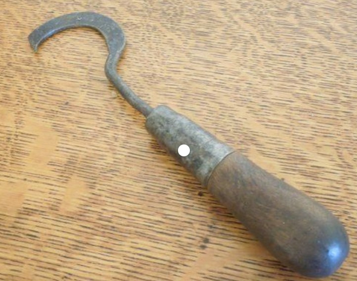

dLj
Mar 23, 2017
5,118
A tool shaped like this is what is what I had in mind. Typically wood working chisels do not have this hooked tip.
The shape of the tip will depend upon the space you are cleaning out.
dj
